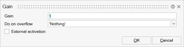

Gain_0
gain
Gain
The gain value
Matrix
overflow
Do on overflow
This parameter defines the way overflow shoudl behandled for integer datatype.
String
'Nothing'
'Saturate'
'Error'
externalActivation
External activation
