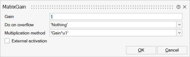

The MatrixGain block computes the product of a matrix Gain by the input matrix u1, where the number of rows/cols of Gain is compatible with the size of u1.
The input/output datatype is defined by the type of the matrix Gain. It can take all the datatype.
MatrixGain_0
gain
Gain
This parameter defines the matrix Gain. That parameter can support all data types.
Matrix
overflow
Do on overflow
Defines the action in case of an overflow during the operation. Options are : "Nothing" (gives a normal, non satured result), "Saturate" (gives a saturated result), "Error" (gives an error message).
String
'Nothing'
'Saturate'
'Error'
mulmethod
Multiplication method
Defines how the matrix multiplication is performed. In the other words, it specifies whether the product is a left, right or element-wise multiplication.Gain*u1u1*GainGain.*u1
String
'Gain*u1'
'u1*Gain'
'Gain.*u1'
externalActivation
External activation
Specifies whether the block receives an external activation or inherits its activation through its regular input ports. When External Activation is selected, an additional activation port is added to the block. By default, external activation is not selected.
Number
0
1
