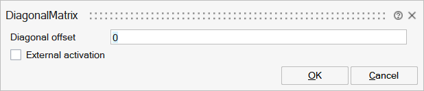

If the offset value is non-zero, the vector will be placed off-diagonal and the matrix size will be (M+|offset|)x(M+|offset|).
DiagonalMatrix_0
offset
Diagonal offset
This used to create off-diagonal square matrix with the input vector.

externalActivation
External activation
Specifies whether the block receives an external activation or inherits its activation through its regular input ports. When External Activation is selected, an additional activation port is added to the block. By default, external activation is not selected.
