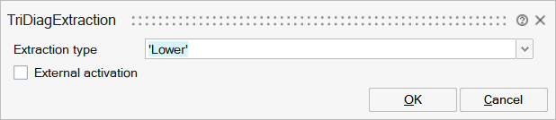

TriDiagExtraction
This block extracts some elements from the input matrix u. When the quot;Extraction typequot; is set to quot;lowerquot;, it copies lower triangular elements to the output matrix of the same size. The elements below the main diagonal are set to zero. When the quot;Extraction typequot; is set to quot;upperquot;, it copies the upper triangular elements to the output matrix of the same size. The elements above the main diagonal are set to zero. When the quot;Extraction typequot; is set to quot;diagonalquot;, it copies the main diagonal elements to the output matrix of the same size. The elements above and below the main diagonal are set to zero.
    TriDiagExtraction
Activate/MatrixOperations
The TriDiagExtraction blocks extracts some elements from the input matrix u. When the quot;Extraction typequot; is set to quot;lowerquot;, it copies lower triangular elements to the output matrix of the same size. The elements below the main diagonal are set to zero. When the quot;Extraction typequot; is set to quot;upperquot;, it copies the upper triangular elements to the output matrix of the same size. The elements above the main diagonal are set to zero. When the quot;Extraction typequot; is set to quot;diagonalquot;, it copies the main diagonal elements to the output matrix of the same size. The elements above and below the main diagonal are set to zero.
When the "Extraction type" is set to "lower", it copies lower triangular elements to the output matrix of the same size. The elements below the main diagonal are set to zero.
When the "Extraction type" is set to "upper", it copies the upper triangular elements to the output matrix of the same size. The elements above the main diagonal are set to zero.
When the "Extraction type" is set to "diagonal", it copies the main diagonal elements to the output matrix of the same size. The elements above and below the main diagonal are set to zero.
TriDiagExtraction_0
decomptyp
Extraction type
Extraction type. Lower, Upper and Diagonal
String
'Lower'
'Upper'
'Diagonal'
