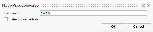

tolerance
Tolerance
Tolerance of the computation.
Scalar
