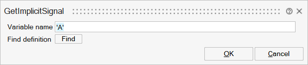

GetImplicitSignal
This block receives implicit signals from a corresponding SetImplicitSignal block by connecting the implicit ports of the blocks without using a link. A single SetImplicitSignal block can send implicit signals to multiple GetImplicitSignal blocks, but a GetImplicitSignal block can receive implicit signals from only one SetImplicitSignal block.
    GetImplicitSignal
Activate/Routing
The GetImplicitSignal block connects implicit ports from one block to another without connecting them physically. It is used with a SetImplicitSignal block. A simple SetImplicitSignal block can send data to multiple GetImplicitSignal, although a GetImplicitSignal can receive data from only one SetImplicitSignal. SetImplicitSignal transports its input data to its corresponding GetImplicitSignal block.
For more information, please refer to the GetSignal block.
GetImplicitSignal_0
tag
Variable name
Signal name.
String
Port 1
implicit
output
1
