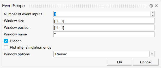

EventScope_0
nin
Number of event inputs
Integer value. Default 1.
Number
winSize
Window size
X,Y dimension of the plot window. Integer values. Default size is given as [-1,-1] and corresponds to [400,400].
Vector of size 2
winPos
Window position
X,Y position of the plot window. Integer values. Default [-1,-1] indicates the scope is positioned automatically.
Vector of size 2
winNam
Window name
Name of the plot window. String. Default is empty.
String
winHidden
Hidden
The window is hidden initially by default.
Number
0
1
showAtEnd
Plot after simulation ends
Display the plots (lines) at the end of simulation instead of progressively along with simulation time.
Number
0
1
option
Window options
Define the scope window setting for a simulation. Default is 'Reuse'.
- 'Reuse': An initial simulation plots results in a scope window. Subsequent simulations plot results in the same window, but any existing data is erased.
- 'Overlay': An initial simulation plots results in a scope window. Subsequent simulations plot results in the same window. Existing plots are retained.
- 'New': Each simulation creates a new scope window.
- 'Recreate': Each simulation produces a new scope window, and the existing scope window is deleted.
String
Port 1
activation
input
nin
