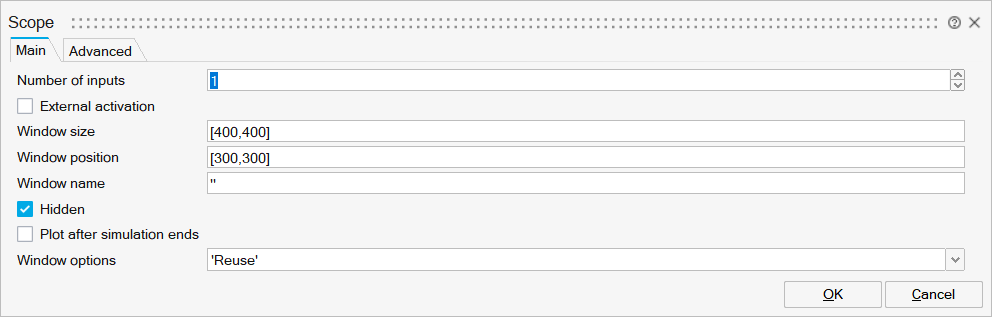

The Scope block displays its input with respect to simulation time. The Scope block allows for multiple inputs.
For defining plot signals,the Scope block provides a number of parameters including axis, range, labels and graphical properties.
Scope_0
nin
Number of inputs
Number of input signals. Integer value. Default 0.
Number
externalActivation
External activation
Specifies whether the block receives an external activation or inherits its activation through its regular input ports. When External Activation is selected, an additional activation port is added to the block. By default, external activation is not selected.
Number
0
1
winSize
Window size
X,Y dimension of the plot window. Integer values. Default size is given as [-1,-1] and corresponds to [400,400].
Vector of size 2
winPos
Window position
X,Y position of the plot window. Integer values. Default [-1,-1] indicates the scope is positioned automatically.
Vector of size 2
winNam
Window name
Name of the plot window. String. Default is empty.
String
winHidden
Hidden
The window is hidden initially by default.
Number
0
1
showAtEnd
Plot after simulation ends
Display the plots (lines) at the end of simulation instead of progressively along with simulation time.
Number
0
1
option
Window options
Define the scope window setting for a simulation. Default is 'Reuse'.
- 'Reuse': An initial simulation plots results in a scope window. Subsequent simulations plot results in the same window, but any existing data is erased.
- 'Overlay': An initial simulation plots results in a scope window. Subsequent simulations plot results in the same window. Existing plots are retained.
- 'New': Each simulation creates a new scope window.
- 'Recreate': Each simulation produces a new scope window, and the existing scope window is deleted.
String
'Reuse'
'Overlay'
'New'
'Recreate'

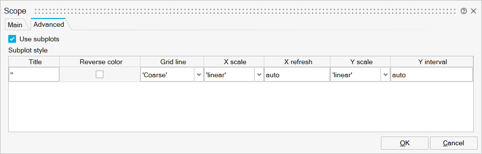

Scope_1
useSubplot
Use subplots
Number
0
1
win_s
Subplot style
Structure
win_s/title
Title
Cell of strings
win_s/reverseColor
Reverse color
Cell of numbers
0
1
win_s/grid
Grid line
Cell of strings
'No
Grid'
'Coarse'
'Fine'
win_s/xScale
X scale
Cell of strings
'linear'
'log'
'db20'
'db10'
win_s/xRefresh
X refresh
Cell of scalars
win_s/yScale
Y scale
Cell of strings
'linear'
'log'
'db20'
'db10'
win_s/yInterval
Y interval
Cell of vectors of size 2
plotTitle
Plot title
String
plotColor
Reverse color
Number
0
1
plotGrid
Plot grid
String
'No
Grid'
'Coarse'
'Fine'
xScale
X scale
String
'linear'
'log'
'db20'
'db10'
xRefresh
X refresh
Scalar
yScale
Y scale
String
'linear'
'log'
'db20'
'db10'
yInterval
Y interval
Vector of size 2
