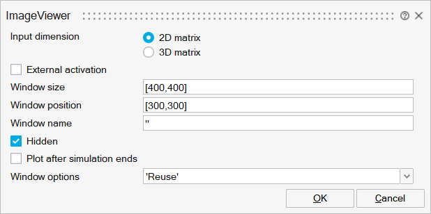

ImageViewer_0
input_dim
Input dimension
Structure
input_dim/in2
2D matrix
Number
0
1
input_dim/in3
3D matrix
Number
0
1
externalActivation
External activation
Specifies whether the block receives an external activation or inherits its activation through its regular input ports. When External Activation is selected, an additional activation port is added to the block. By default, external activation is not selected.
Number
0
1
winSize
Window size
X,Y dimension of the plot window. Integer values. Default size is given as [-1,-1] and corresponds to [400,400].
Vector of size 2
winPos
Window position
X,Y position of the plot window. Integer values. Default [-1,-1] indicates the scope is positioned automatically.
Vector of size 2
winNam
Window name
Name of the plot window. String. Default is empty.
String
winHidden
Hidden
The window is hidden initially by default.
Number
0
1
showAtEnd
Plot after simulation ends
Display the plots (lines) at the end of simulation instead of progressively along with simulation time.
Number
0
1
option
Window options
Define the scope window setting for a simulation. Default is 'Reuse'.
- 'Reuse': An initial simulation plots results in a scope window. Subsequent simulations plot results in the same window, but any existing data is erased.
- 'Overlay': An initial simulation plots results in a scope window. Subsequent simulations plot results in the same window. Existing plots are retained.
- 'New': Each simulation creates a new scope window.
- 'Recreate': Each simulation produces a new scope window, and the existing scope window is deleted.
String
'Reuse'
'Overlay'
'New'
'Recreate'
