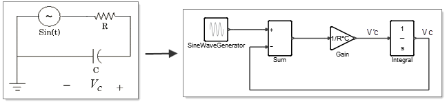

The process of modeling dynamic systems includes assembling blocks that exchange data through a network of input and output ports. Though possible to model physical systems with the basic Activate blocks, the process requires translating into explicit form the implicit equations that represent the behavior of the physical components. In addition, the resulting diagrams have an unconventional appearance compared to component-based diagrams as you can see in the following figure.
Figure 1. Component-Based Diagram (left) and Activate Diagram (right)

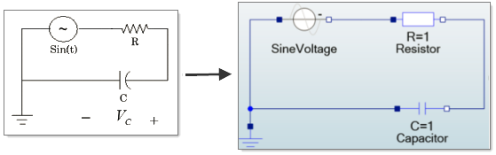

Benefits of Modeling with Implicit Blocks
Figure 2. Conventional Diagram (left) and Activate Diagram with Implicit Blocks (right)

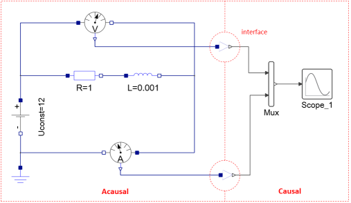

Combining Component and Block Models
A component model and block model can be interconnected using special interface blocks as you see in the following diagram:
