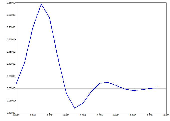

Example
Verify the impulse response of a fourth order Butterworth low pass digital filter with a 300 Hz cutoff frequency and a 2000 Hz sampling frequency.
[b,a] = butter(4,300/(2000/2));
ts = 0.0005;
tfb = tf(b,a,ts);
impulse(tfb);
Figure 1. impulse figure 1
