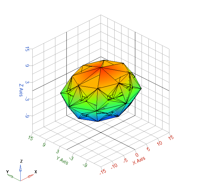

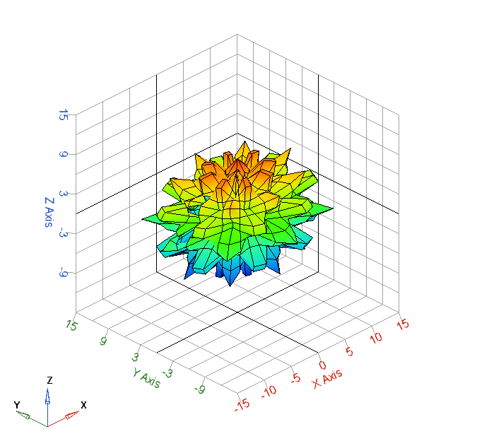

Example
n = 40;
theta = [1:1:n]/n*(2*pi);
theta = repmat(theta,n/2,1);
phi = [1:1:n/2]'/(n/2)*pi;
phi = repmat(phi,1,n);
xx = 10*(1 + 0.4*cos(8*theta).*cos(8*phi)).*(cos(theta).*cos(phi));
yy = 8*(1 + 0.4*cos(8*theta).*cos(8*phi)).*(cos(theta).*sin(phi));
zz = 6*(1 + 0.4*cos(8*theta).*cos(8*phi)).*sin(theta);
surf(xx,yy,zz);
xlim([-15, 15]);
ylim([-15, 15]);
zlim([-15, 15]);
P = [xx(:), yy(:), zz(:)];
h = convhulln(P);
figure;
surf(xx(h), yy(h), zz(h));
xlim([-15, 15]);
ylim([-15, 15]);
zlim([-15, 15]);
Figure 1. convhull figure 1
        Figure 2. convhull figure 1Comments
