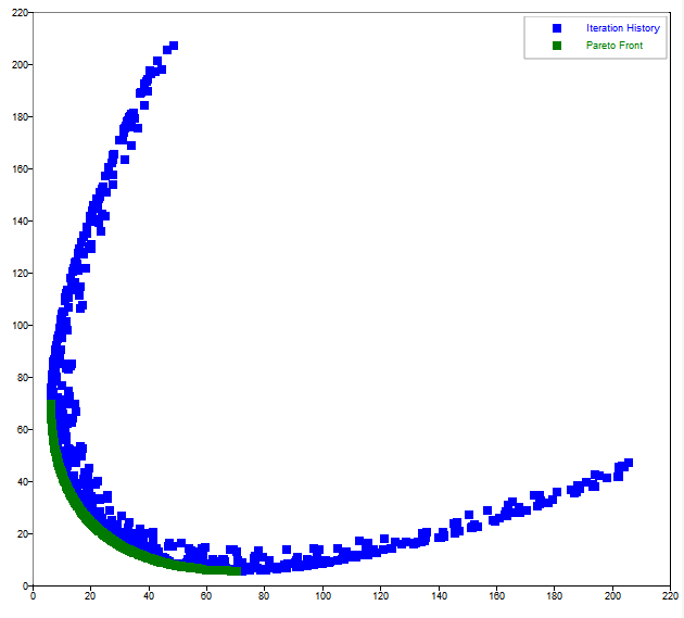

Examples
Plot the iterations and Pareto Front for the function ObjFunc.
function obj = ObjFunc(x)
    obj = zeros(2,1);
    obj(1) = 2*(x(1)-3)^2 + 4*(x(2)-2)^2 + 6;
    obj(2) = 2*(x(1)-3)^2 + 4*(x(2)+2)^2 + 6;
end
init = [2; 0];
lowerBound = [1, -5];
upperBound = [5, 5];
options = mogaoptimset('MaxIter', 40, 'Seed', 2017);
[x,fval,info,output] = moga(@ObjFunc,init,[],[],[],[],lowerBound,upperBound,[],options);
obj1 = output.fvaliter(:,1);
obj2 = output.fvaliter(:,2);
scatter(obj1, obj2);
hold on;
obj1P = fval(:,1);
obj2P = fval(:,2);
scatter(obj1P, obj2P);
legend('Iteration History','Pareto Front');
Figure 1. moga figure 1
