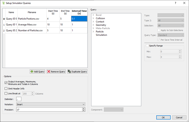

Adding queries to your simulation
When you select the Simulator Queries checkbox, the Setup Simulator Queries dialog box is displayed where you can define queries.
In the Setup Simulator Queries dialog box, the options to define queries can all have a unique Start Time, End Time, and Interval Time similar to those in EDEM Analyst.
After you have defined the queries, start the simulation. The csv files will be copied to the folder which contains the .dem file associated with the simulation.

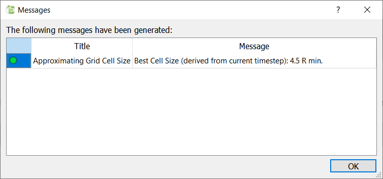

Simulator Grid (OpenCL and CPU Engine only)
EDEM calculates the smallest particle size in the simulation (Rmin). You then set a grid cell size based on this particle size. 3 Rmin is the default value, typical ranges are 3-6 Rmin, the Estimate Cell Size option provides guidance on the optimal Cell Size for a specific simulation Time Step. The grid does not impact on the simulation results, only the simulation speed. A smaller grid size results in more memory (RAM) usage; reducing the grid cells size below 2 Rmin can result in a significant slow-down for the simulation.
Click the Show Simulator Grid  icon to display the CPU engine/ Particle-Particle grid in the Viewer.

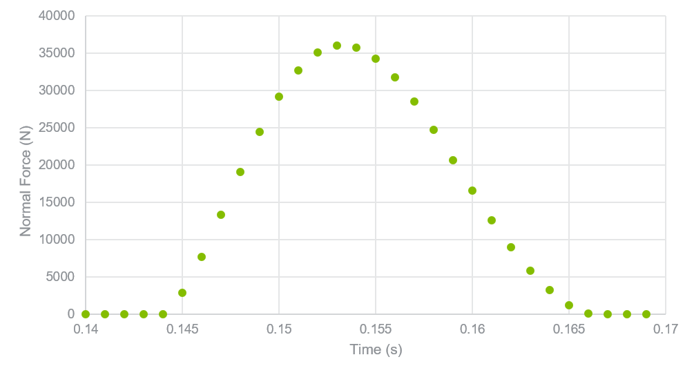

Storing Collision Data
Example force-time graph for a single particle-geometry collision where each point is a contact.
During a simulation, data can be recorded about both contacts and collisions.
  1. Contacts are the impacts occurring between elements at data write-out points. In other words, the contact is in progress when the write-out takes place. The contact has an associated force, position and so on - these are discrete values. If two elements stay in contact with each other for some time such as over 4 write-out points, four contacts will be stored and each of these may have a different force, position and so on.
  2. Collisions are complete impacts.  When two elements collide it will register as one collision, regardless of how long the elements stay in contact for. Data is collected for the duration of the collision. for example, total energy loss, min/max/average normal force data and so on. Collisions may occur in-between write-outs and never register as contacts.
EDEM records all contact data as standard. To record collision data, enable Track Collisions. Storing collision data will significantly increase memory usage and reduce the speed of the simulation. Collision data is stored in memory until it is written out at the rate specified in the Simulator. If a large number of collisions are occurring and the write out frequency is too low, the amount of data being stored in memory will become very large and use up all memory resources. To minimize this, be sure data is written out frequently.
As of EDEM 2020.1, the forces reported by EDEM for collisions are undamped.

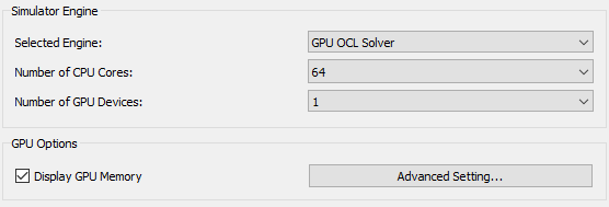

Simulator Engine

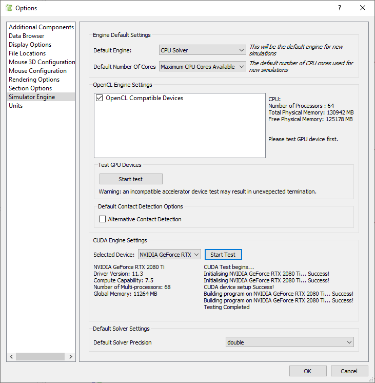

A simulation can run in CPU mode or in GPU mode. GPU mode requires supported GPU hardware. There are two GPU engines, the CUDA engine and the OpenCL engine.  The CUDA engine will run Polyhedral, Sphero-Cylinder and Multi-Sphere simulations and requires a suitable Nvidia graphics card. The OpenCL engine will run Multi-Sphere simulations and will run on any graphics card which support OpenCL.
Selecting Engines

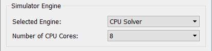

You can select CPU, OpenCL or CUDA Engine. If the GPU option is not available, verify GPU compatibility using the CPU Solver as follows:
You can select the number of CPU cores, the number available depends on the CPU hardware available.
The Selected Engine allows you to select the GPU solvers.The number of GPU devices can be set. In addition,you can select the number of CPU Cores, as the processing is handled by the GPU card up to 4 CPU’s are recommended as the optimal value.

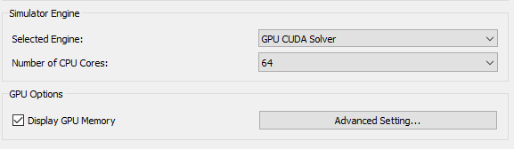

Checking CUDA GPU Compatibility
GPU CUDA engine requires your GPU device to support Nvidia CUDA 11.2 or above. To check hardware compatibility with the GPU go to Tools > Options > Simulator Engine and select the GPU’s from the list and then choose Start test. As shown below EDEM will report if the test and GPU setup is successful. If multiple GPU devices are found a test should be run on each GPU device required to run EDEM.
The test is a standard hardware test for Nvidia CUDA GPU. If the test fails, ensure that your Graphics Card drivers are up to date and try again or contact support with details of the GPU device used.
Only once the test has been run successfully will the GPU option be accessible from the Selected Engine dropdown menu.
GPU CUDA Solver
When you select the CUDA GPU Solver engine, you are presented with the following options:
Number of CPU Cores
The CUDA GPU engine works with both CPU and GPU. The recommended number of CPU cores when running CUDA GPU is 4 as this provides a good balance of speed vs. CPU use.
Total available memory size
This value shows the value in Megabytes that the percentage above represents for the selected GPU device.

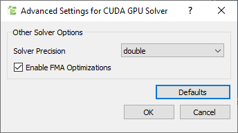

GPU CUDA Advanced Settings
The advanced options for the CUDA GPU solver allow users to modify the precision used for the simulation and disable FMA optimizations.
EDEM allocates a set number of bytes of memory to store simulation information, such as particle position or velocity. The larger the number of bytes it allocates the greater the precision EDEM can work with. By default, EDEM simulations use 8 byte or "Double" precision storage. This means that information is stored at a very high precision. In many applications this level of precision is excessive and has a negligible benefit to the accuracy of simulations. High precision also slows down simulations due to the extra computational expense required to perform operations and slower memory storage/management.
Therefore, there are significant speed benefits to using the lower precision "Single" data type which only uses 4 bytes. It is possible that only using Single precision data may lead to noticeable differences in simulation results, compared to Double precision. Rather than solely using either Single or Double precision a combined, Hybrid, approach can be taken. This is achieved by storing key simulation parameters (such as particle position) in double precision and using Single precision for the remaining properties. The result of this method produces simulations running nearly as fast as solely using single precision, whilst maintaining most of the accuracy of double precision. In order to maintain most of the accuracy of Double precision, storage of key simulation properties is, whilst gaining the computational speed a mixture of these data types can be used in a Hybrid method.
The following precision methods are available in EDEM:
Double
  1. Standard data type for EDEM
  2. Highest precision
  3. Slowest simulation speed
Single
  1. Lowest precision
  2. Computational speeds up to 2.5x faster than double
Hybrid
  1. Strategic usage of Double and Single precision
Disabling FMA in CUDA
There is an optimization applied by the CUDA compiler known as 'fused-multiply-add' which combines addition and multiplication into a single instruction. More information is available at the following location: 
https://docs.nvidia.com/cuda/floating-point/index.html#fused-multiply-add-fma
This will give improved performance, however there are some cases where it can cause the simulation results to change by a small amount. Therefore it can be helpful to disable this option when developing new code and trying to compare results between versions. This optimization can be disabled by passing the command line option --nofma=1 or by disabling it in the Advanced Setting dialog in the simulator options.
This is a technical option that be enabled as it is the default setting.

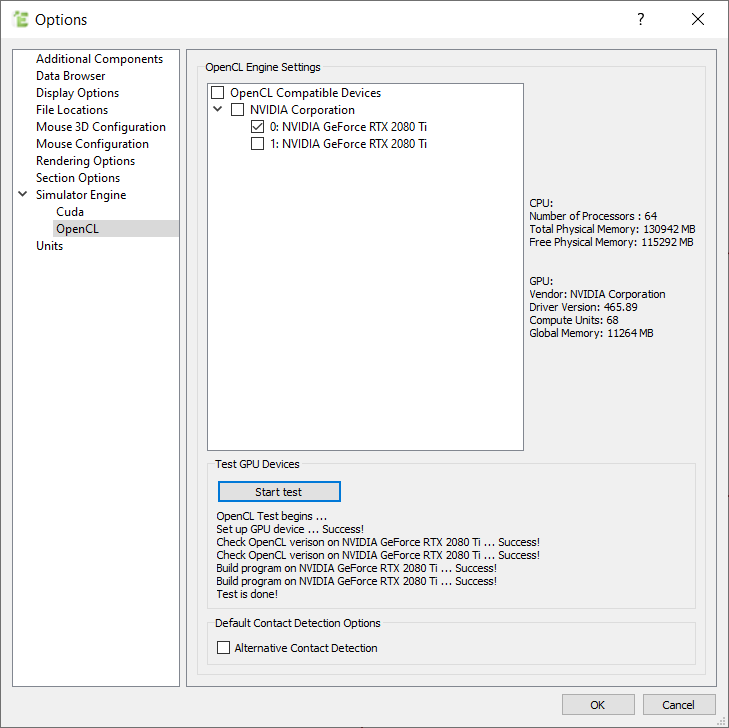

Checking OpenCL GPU Compatibility
EDEM GPU OpenCL engine requires your GPU device to support OpenCL 1.2 or above. To check hardware compatibility with the GPU, go to Tools > Options > Simulator Engine > OpenCL and select the GPU’s from the list and then select Start test. As shown, EDEM will report if the test and GPU setup is successful. If multiple GPU devices are found, a test should be run on each GPU device required to run EDEM.
The test is a standard hardware test for GPU. If the test fails, please make sure your Graphics Card drivers are up to date and try again or contact support with details of the GPU device used.

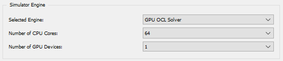

GPU OpenCL Solver
When the OpenCL GPU Solver engine is selected, you are presented with the following options and information:
  1. Number of CPU Cores
    The GPU engine works with both CPU and GPU. The recommended number of CPU cores when running GPU is 4 as this provides a good balance of speed vs. CPU use. If using the GPU with the EDEM API then the API models run on CPU when the contact detection runs on the GPU. As such, depending on the complexity and definition of the API model more than 4 CPUs may provide the optimal speed.
  2. Number of GPU Devices
    This displays the Number of GPU Devices available on the installed GPU hardware, this is not a value that can be modified. The definition of Compute Unit differs depending on the GPU manufacturer. A compute unit is a Stream Multiprocessor for an NVidia GPU or a SIMD engine in an AMD GPU. For Nvidia each stream multiprocessor has a certain number of processing elements or what Nvidia calls ‘CUDA Cores’. Typically the more processing elements the faster the GPU card.
  3. Available memory percentage
    Indicates the maximum % of the computer’s graphic memory that EDEM is going to use. The default value is set to 75% in order to allow some memory for other non-EDEM related processes.
  4. Total available memory size

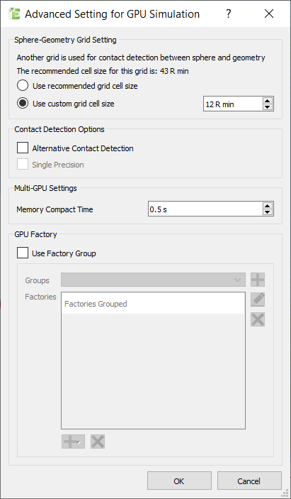

GPU OpenCL– Advanced Settings
When selecting the GPU solver engine, the GPU Advanced settings are available:
  1. Sphere-Geometry Grid Settings
    You can set the Sphere-Geometry (Particle-Geometry) grid settings to be a different value to the Sphere-Sphere grid. The default recommended value targets the fastest simulation speed for GPU. However, you can also set your own custom value.
  2. Alternative Contact Detection
    The alternative contact detection Method is a hybrid contact detection option which switches between two algorithms depending on simulation settings.  The algorithms primarily offer benefits when working with a large particle size distribution or with a domain consisting of small amounts of empty space. In these situations memory usage should be reduced resulting in an ability to run larger simulations in comparison to the standard contact detection Method.
    This feature is available to use but it is recommended that you test if gains are achieved before activating for mainstream work.
  3. Multi-GPU Settings
    “Memory Compact Time” defines an interval at which Multi-GPU simulations will do a memory compact - reducing the physical GPU memory used while running Multi-GPU simulations. This is achieved by removing unused blocks of memory generated when particles pass from one GPU domain to another. This same process happens during regular save internals so “Memory Compact Time” will only have a significant impact when saving infrequently (i.e. when Save Interval > Memory Compact Time). Default value is 0.5 s and it is not advised to use very small values since this will impact simulation performance.
  4. GPU Factory
    If ‘Use Factory Group’ is selected then this allows you to group particle factories together. All the particles in a simulation are created and tracked within factory domains by the CPU. The CPU will stop processing these particles and hand them over to the GPU once they leave the factory domain. If they re-enter or cross any factory domain afterwards, the CPU will not acknowledge them. Any particles re-entering the factory will likely lead to a particle explosion in the factory domain.
    To avoid this unexpected behavior, if several factories are close to each other and the particles might pass through each other’s factory domain, you can enable “Use Factory Group”. This feature allows you to group several factories together in order to make EDEM deal with them as one factory domain through the CPU.
    The larger the number of particles inside the factory domain (one factory or one group of factories), the higher the CPU usage and the lower the GPU usage involved. In extreme cases, where the factory covers the whole domain, all particles would be processed by CPU.
    At the same time, EDEM will detect when a factory stops generating particles. Hence, the corresponding factory domain would become invalid and all the particle information within it would be handed over from CPU to GPU to proceed with the calculations.
    1. Use Factory Group checkbox
      Enable/Disable the use of factory groups in the GPU simulation.
    2. Groups
      The dropdown list shows all the factory groups already defined. Add/delete a new group by clicking on the green/red crosses next to the selected group. You can also rename a Factory Group.
    3. Factories
      The box shows the Grouped Factories within the highlighted Group in the “Groups” dropdown list. Factories can be added and removed with the green/red cross below the Factories box. Any factory defined in the creator that has not been used in any other Factory Group will be selectable for a new grouping.
Number of Cores
This enables the number of processor cores used in the simulation to be specified via the Number of Cores dropdown. When you start a simulation, EDEM checks out the requested number of units from the license system (if available).
If your computer has hyper-threading enabled, EDEM will include these in the number of processors but these will not provide the same performance improvement as real cores.

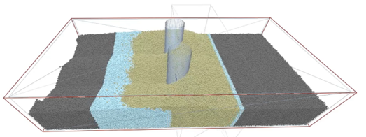

Visualization
While simulating, frozen particles are shown in blue/black, while unfrozen particles are shown in yellow:
The black coloring is shown only on the CUDA solver. It indicates that the particles are not only frozen but, have also been completely offloaded from the GPU (further increasing performance). The difference is only visible while simulating; it has no impact on results.
When a geometry object is defined as Visualization, all material inside the Object will be active and any stationary material outside the object will be excluded from any calculations, which improves simulation speed.  A particle excluded from any calculation is called a frozen particle. If a frozen particle re-enters the Visualization then it is automatically included in the calculations again.
To use this feature, a geometry section must first be defined as a Visualization in the Creator. To do this, right click on the Geometries section, select Add Geometry and choose Box. Rename the new geometry and set the Type to Visualization. Please note, since the Bulk Material will not physically interact with the Visualization object, there is no option to assign material when Visualization has been selected.
Next, set the dimensions of the Visualization Object suitable for the simulation, any material inside the domain will be active and any outside may become frozen.
In the Simulator there are three main parameters for Visualization.
Check Interval
If the particle does not move in this time interval and it is outside the Visualization then the particle is flagged to be frozen.
Number of Checks
This determines the number of times EDEM will perform the check to see if a particle is to be frozen.
Displacement of Particles as a Percentage of the Radius
This is the condition that determines if the particle is stationary or moving. If the displacement of the particle within the Check Interval is greater than this value then the particle is considered to be moving, otherwise it is stationary and can be removed from the force and contact detection calculations.
Visualization is based on the method outlined in Mio et al., 2009.
Visualization Known Issues
  1. Visualization is not compatible with Multi-GPU.
  2. Frozen particles do not apply forces on geometry sections.
  3. Frozen particles are excluded from Contact Detection, forces and velocities are not computed.

Estimating Cell Size
The estimate cell size is a heuristic algorithm which, based on the current simulation Time Step, will estimate the best cell size. Selecting this option will launch the approximation program and return an estimated best value for simulation performance:
