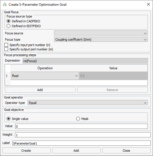

S-Parameter Goal
Optimise the S-parameters that are solved as part of the Feko model.
Figure 1. The Create S-Parameter Optimisation Goal dialog.
The Focus source is identified based on the label of a Multiport S-parameter request in CADFEKO or the Focus source label of an SP card in EDITFEKO.

Port Selection
- Specify input port number (n)
- By default all of the active ports will be considered during the goal evaluation. When activated, this option allows the selection of a single port to be used as the input port. For example, if all of the S-parameters in a 3-port device are computed and the Focus quantity is chosen as Coupling coefficient (Smn), then if the input port is specified as 2, only the values of S12 and S32 will be considered during the goal evaluation.
- Specify output port number (m):
- In a similar manner to the input port selection option, when this option is selected it allows the selection of a single port to be used as the output port. For example, if all of the S-parameters in a 3-port are computed and the Focus quantity is chosen as Coupling coefficient (Smn), then by specifying the output port as 2, only the values of S21 and S23 will be considered during the goal evaluation.
