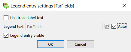

Editing Legend Text
Modify or remove the legend entry text.
Use the trace label (displayed in the result palette) as the legend text.
