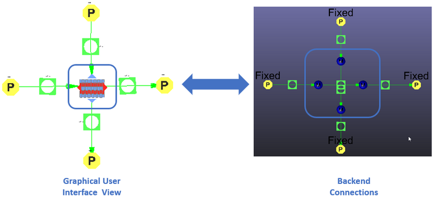

The Plate Fin Heat Exchanger can be used in Compressible and Incompressible (hydraulic and non-hydraulic) simulations. The component has four fluid connections and it models heat exchange between two streams in a network. Heat Exchangers in Flow Simulator come with four hidden chambers representing the four sides of the heat exchanger. The Plate Fin Heat Exchanger uses Orifice elements (Compressible or Incompressible) in the backend to model restriction losses (pressure loss) of both flow paths based on Friction Factor correlations for different Fin Configurations and characteristic flow area. The Heat addition/removal is calculated by the E-NTU method in the PlateFin Hx module, and Q (Heat Addition/Removal) is supplied to Orifice Elements to predict the temperatures of the exiting fluids.

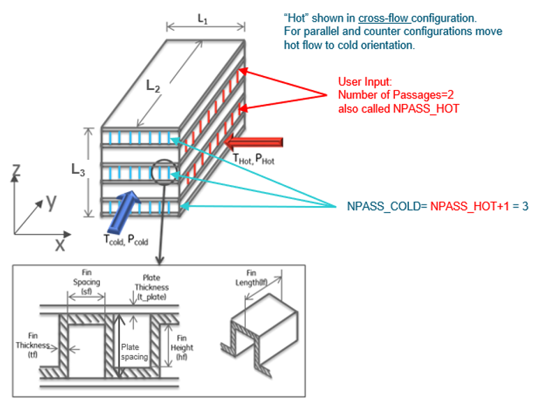

Figure 2. Important modeling aspects when using the heat exchanger components include:

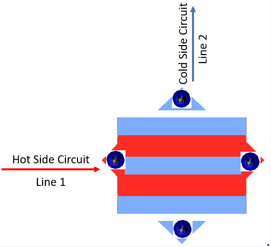

- The Hot Side circuit must be connected to line 1 (red part in the image below) and
the Cold Side circuit must be connected to line 2 (the blue part in the image
below):
Figure 3. - The Hot/Cold Side circuit line must be connected with either compressible or Incompressible set of elements. Mixing of elements sets for a Hot/Cold side circuit line is not allowed. Plate Fin Heat Exchanges supports following fin configurations. The Heat Transfer Coefficient and Friction factor for various configurations are calculated based on public literature which are provided in theory manual below.

Figure 4. Plate Fin Heat Exchanger Dimension Details| Index | Field | Description |
| 1 | Length in X Direction (L1) | Dimensions of Heat Exchanger (Refer Image Above) |
| 2 | Length in Y Direction (L2) | Dimensions of Heat Exchanger (Refer Image Above) |
| 3 | Length in Z Direction (L3) | Dimensions of Heat Exchanger (Refer Image Above) |
| 4 | Number of Passages (NPASS) | Number of Hot Passages |
| 5 | Flow Configurations | Configuration of Heat Exchanger
| 6 | Fin Configurations | Fin configurations
| 7 | Fin Material | Fin Material. By default, two Standard Materials are listed.
Any Custom Material defined using the Material Manager under the solid category is available for selection apart from the above-mentioned standard materials. |
| 8 | Fins per Inch | No of Fins per Inch |
| 9 | Plate Spacing (H) | Distance between Plates |
| 10 | Fin Thickness (t) | Thickness of Fin (Refer to Image Above) |
| 11 | Offset Length (w) | Offset Length (Used for Offset Fin Configurations) (Refer Image in Theory Sections) |
| 12 | Wave Length (p) | Wavelength (used for Wave Fin Configurations) (Refer to Image in Theory Sections) |
| 13 | Louver Pitch (Lp) | Louver Pitch (used for Louver Fin Configurations) (Refer to Image in Theory Sections) |
| 14 | Louver Height (Lh) | Louver Height (used for Louver Fin Configurations) (Refer to Image in Theory Sections) |
| 15 | Plate Material | Plate Material. By Default, two Standard Materials are listed.
| 16 | Plate Thickness | Plate Thickness (Refer to Image Above) |
| 17 | Bar/end Plate Thickness | End Plate Thickness |
| 18 | Colburn J factor coefficient A J_ACOEFF | Coefficient A for Colburn J factor (Refer to Equations in Theory Manual) |
| 19 | Colburn J factor coefficient B J_BCOEFF | Coefficient B for Colburn J factor (Refer to Equations in Theory Manual) |
| 20 | Friction factor coefficient A F_ACOEFF | Coefficient A for Friction F factor (Refer to Equations in Theory Manual) |
| 21 | Friction factor coefficient B F_BCOEFF | Coefficient B for Friction F factor (Refer to Equations in Theory Manual) |

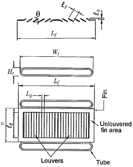

Louver Fins:
Lp - louver pitch
Ll - louver length
Fh - fin height (plate spacing)
Lh - louver height

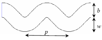

Figure 6. Wavy Fins:
