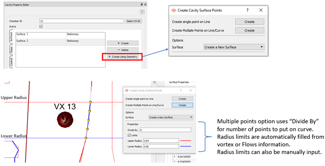

- Cavity Surface Creation Using CAD Curves
- You can select cavity surface points directly on CAD curves. Previous versions only used the cursor position on the screen for point creation. To create single points, click on the curve or create multiple points with one click.

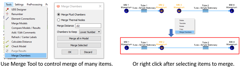

- Merge Fluid Chambers or Thermal Nodes
- You can automatically merge chambers or thermal nodes that lie close to one another. This is useful if duplicate chambers exist after copying a group of elements. It can also be used if automatic element creation using CAD leaves two disconnected elements that should be connected. Use Discard or Undo if there are problems with the merge.

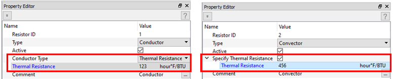

- Thermal Resistance Inputs for Conductors and Convectors
- Thermal resistors take a thermal resistance input in place of geometric and material properties. New input makes it convenient when you need to enter a thermal resistance.

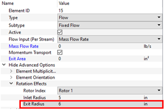

- Fixed Flow Element Exit Radius
- The fixed flow element has an exit radius input. Previous versions just had a single radius. Use the exit radius for models using fixed flows instead of typical elements (like vortex and orifice) in simplified cavity analysis. If the exit radius is 0, it is assumed to be the same as the inlet radius.

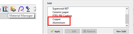

- Aluminum and Copper Solid Properties
- Material properties for aluminum and copper are now included in Flow Simulator.

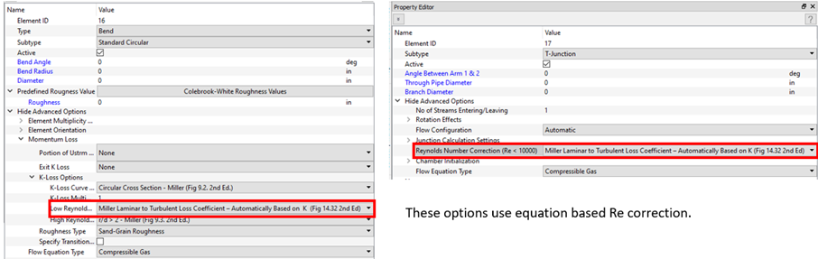

- Improve Reynolds Number Correction
- Several elements (orifice plate, transition, valve) use a Reynolds number correction for loss factor (k). Many empirical k’s are based on a turbulent Re. If an element has a laminar Re, the turbulent k is corrected. The correction factor can come from tables or an equation. The existing tables were modified to improve performance of the linear interpolation. The equation option was added to the junction and bend.
