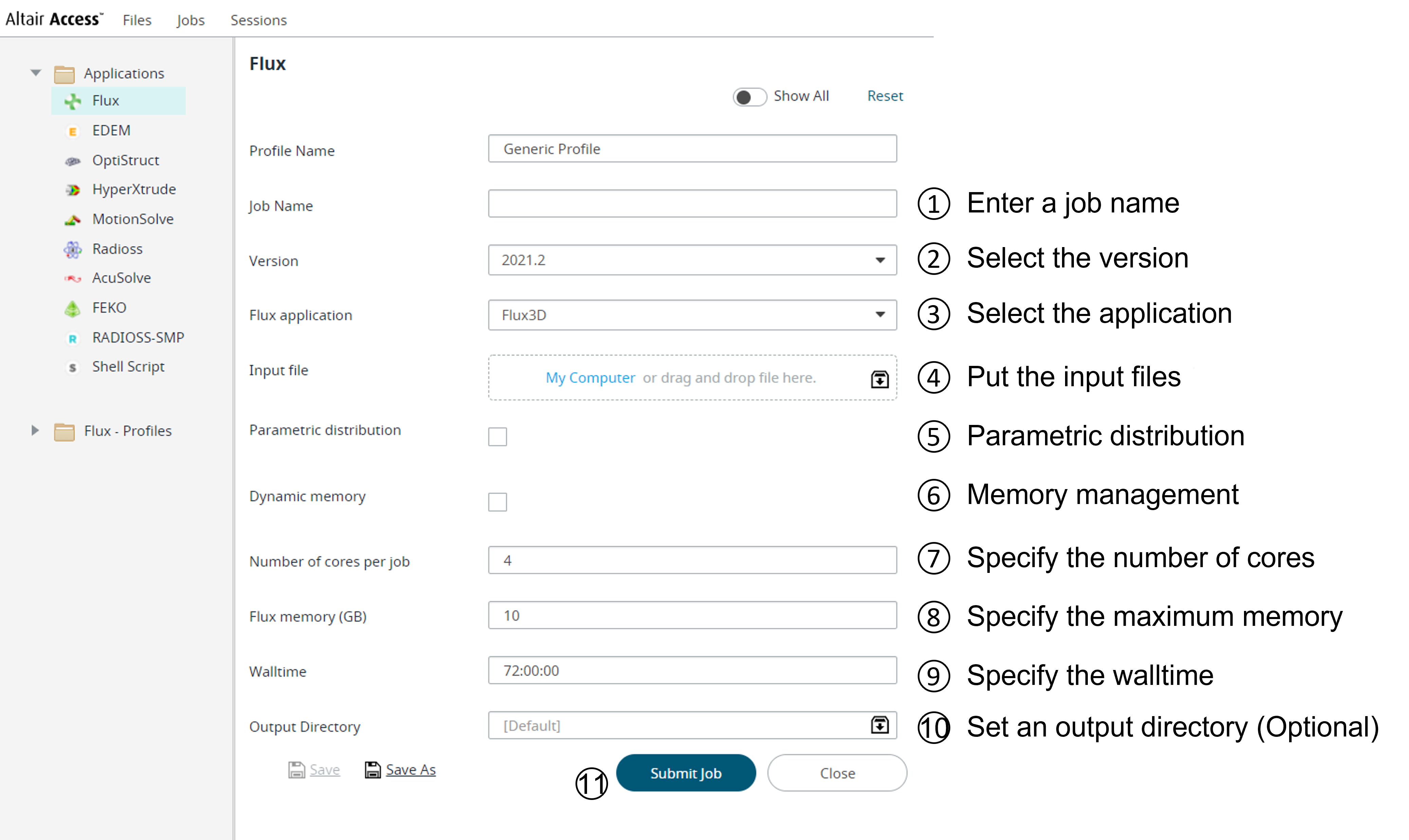

Reach the submission page of your PBS installation and select Flux application.
 Job Name
                Job Name
Enter the name of the job to be submitted.
 Version
                Version
In the dropdown list, select the item corresponding to the version of Flux ™ that you want to use.
 Flux application
                Flux application
In the dropdown list, select the Flux application of all inputs: Flux2D, Flux3D, FluxSkewed or FluxPEEC
 Input file
                Input file
Put the file containing the Flux project(s) to solve and/or python script(s) to execute. See the next section for more details.
 Parametric distribution
Enables the parametric distribution feature. Let it uncheck for this section.
 Memory management
                Memory management
Check to enable the dynamic memory management.
 Number of cores per job
Set the number of cores you want to use per job.
 Memory (GB) per job
                Memory (GB) per job
Set the amount of memory (in GB) you want to allocate per job.
 Walltime
                Walltime
Set the maximum duration of the job. The job will be killed once this duration is exceeded.
 Output Directory
                Output Directory
Optionally you can set the output directory of your choice. The output directory will contain the results. By default, the system will automatically create and assign a stage directory.
 Submit
                Submit
Click to submit the job. The job status can be found in the Monitoring page.
