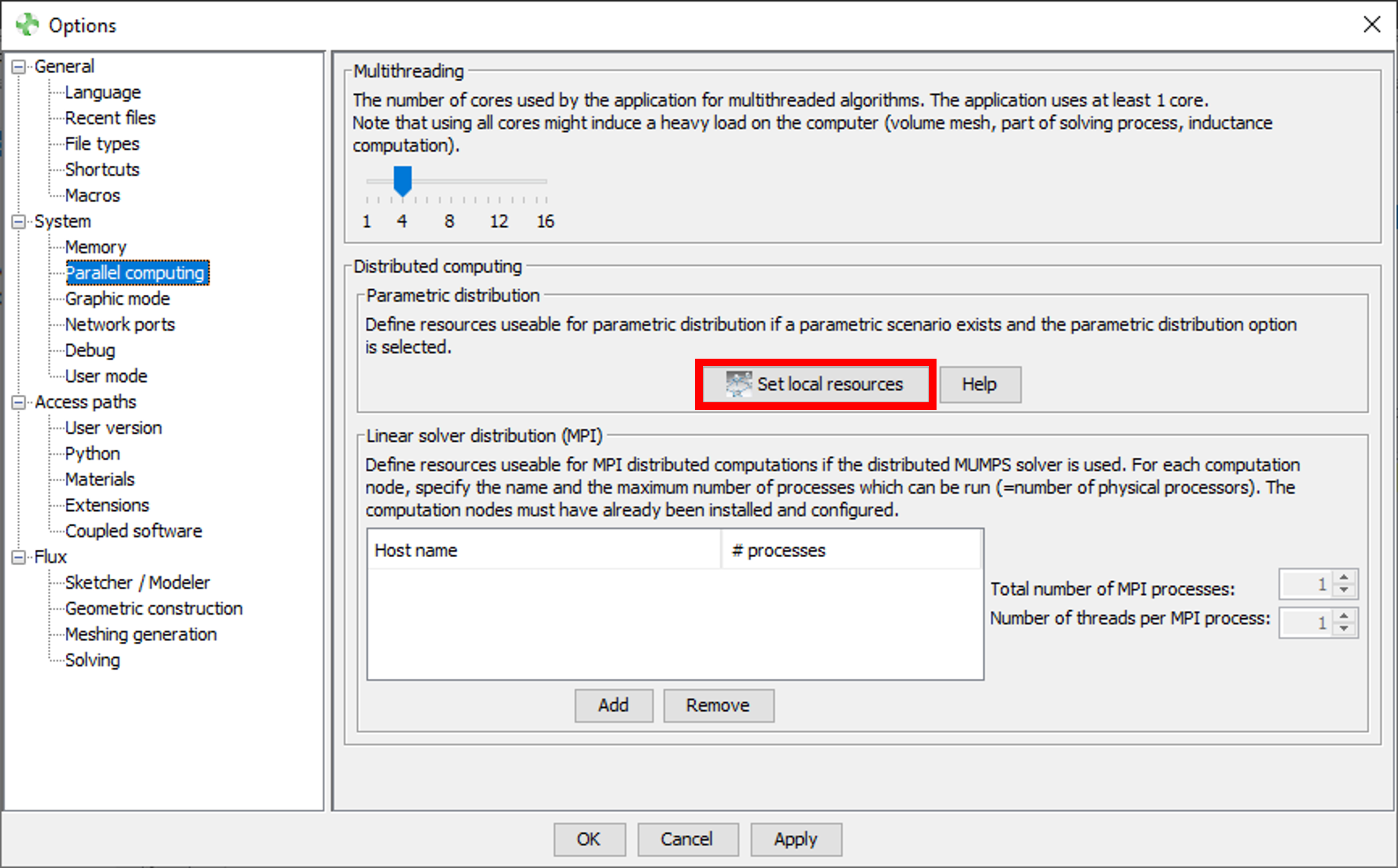

In any case, the parametric distribution may be setted as follows:
The Distribution manager may be started in the Supervisor's options,
in the Parallel Computing menu, in the section Distributed
Computing and then Parametric Distribution click on the
button Set local ressources as shown below;
Figure 1. The supervisor's options allowing the user to set the parametric
distribution.

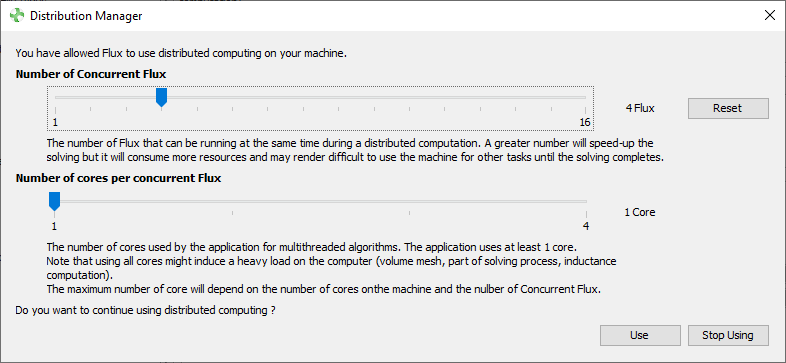

The Distribution manager then asks for the Number of concurrent
Flux as follows:
Figure 2. The distribution manager asking for the Number of Concurrent
Flux.
This number is directy linked to the number of cores available on the
machine, the numbers of varying parameters are automatically distributed
over the number of concurrent Flux. The secondary Flux are automatically
run in monocore mode but may be changed by using the slider
Number of cores per concurrent Flux.
Finally, click on Use to complete the parametric distribution
