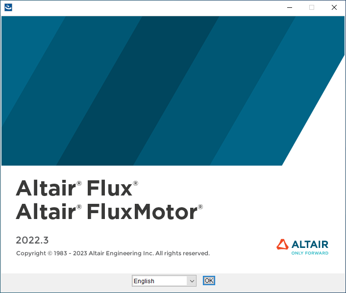

- Run the executable file hwFluxFluxMotor2022.3_win64.exe
 - Select a language
- Click on the OK button

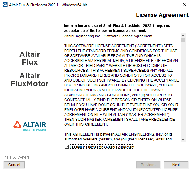

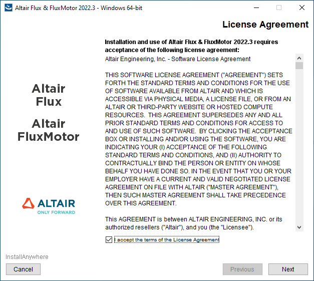

                        (License Agreement panel):
                - Read through the license agreement and if you accept the terms of the License Agreement, then check the I accept the terms of the License Agreement box
- Click on the Next button to start with the Altair Flux & FluxMotor 2022.3 installation

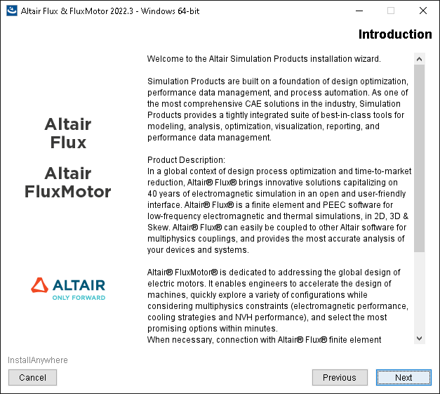

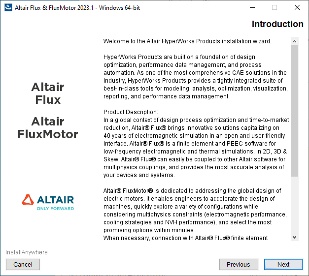

                        (Introduction panel):
                - Read the introduction and click on the Next button to continue with the Altair Flux & FluxMotor 2022.3 installation

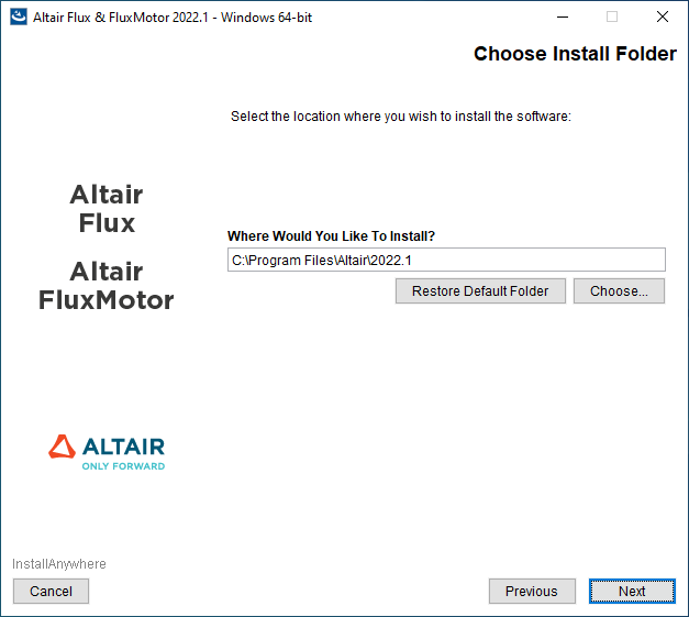

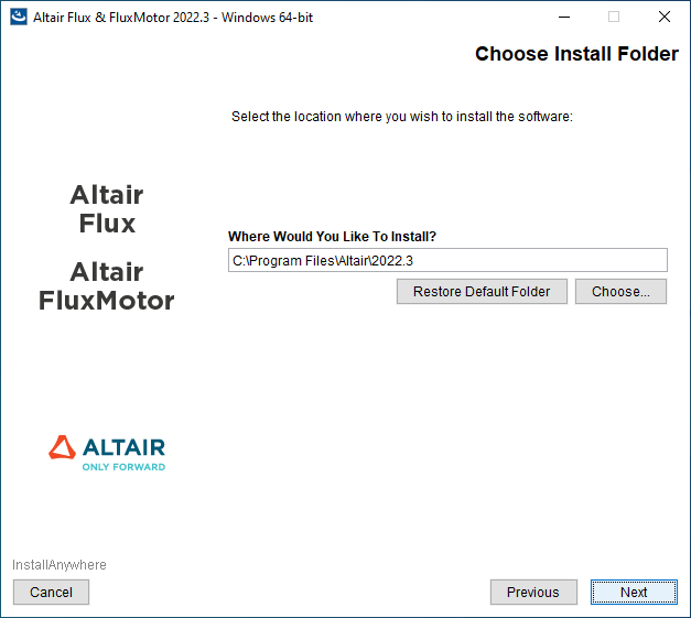

                        (Choose Install Folder panel):
                - Choose an installation directory:- By default:- with a user account: the installation directory is C:\Users\<username>\Altair\2022.3
- with an administrator account: the installation directory is C:\Program Files\Altair\2022.3
- You can specify another installation directory, however, make sure that the full directory path does not include any special characters, then click on the Choose button
- By default:
- Click on the Next button to continue with the Altair Flux & FluxMotor 2022.3 installation

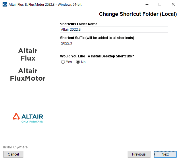

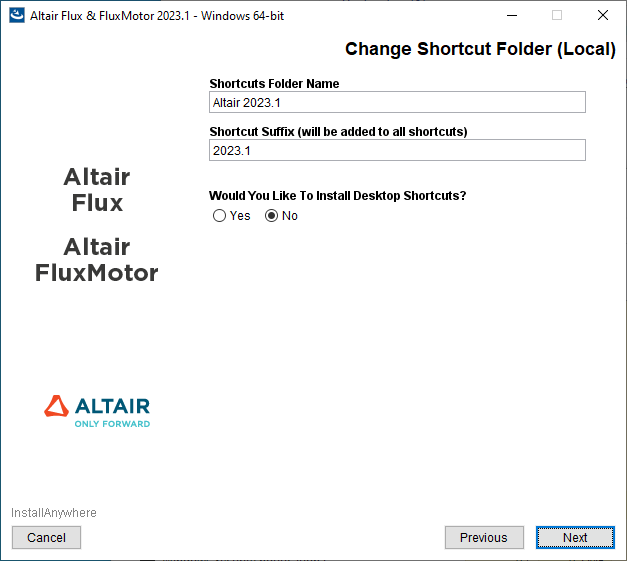

                - Specify the folder name that will contain the start menu shortcuts.
- Specify the suffix string to be added to the shortcuts (Optional).
- Select one of the following options:- Yes if you want to add the Altair Flux & FluxMotor shortcuts on the desktop
- No if you do not want to add the Altair Flux & FluxMotor shortcuts on the desktop

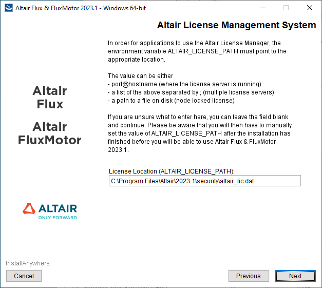

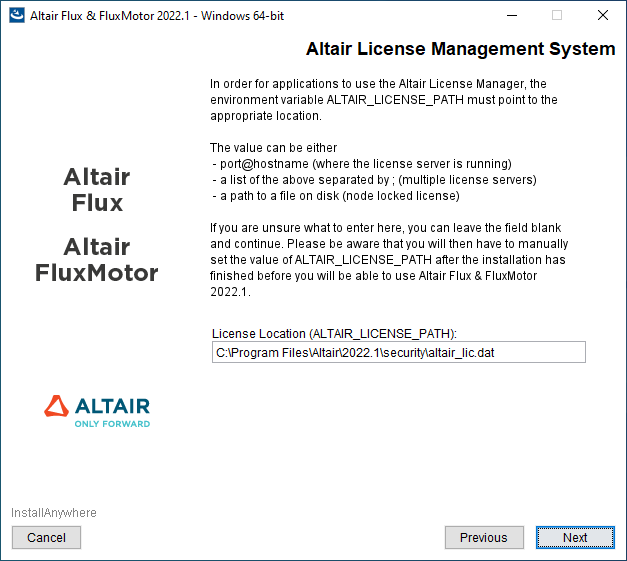

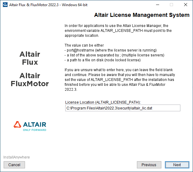

                        (Altair License Management System panel):
                - Enter the license location:- If you have a network license, then enter
                                        port@hostnamewhere port is the TCP/IP port number used by the license server and hostname is the name of the license server computer
- If you have a local license (standalone license), then enter the full pathname of the license file
                                        port@hostname
 Note: This window is only displayed if the license has not yet been configured.

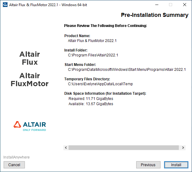

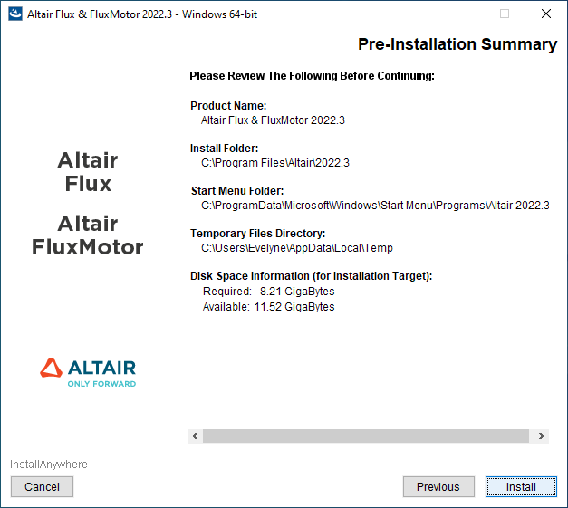

                        (Pre-Installation Summary panel):
                - Review the installation details and click on the Install button to start the Altair Flux & FluxMotor 2022.3 installation

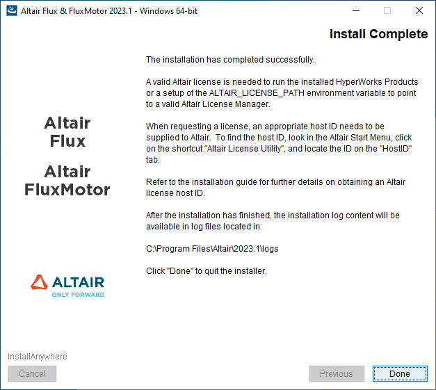

                        (Install Complete panel):
                - Click on the Done button to complete the Altair Flux & FluxMotor 2022.3 installation and exit the installer
