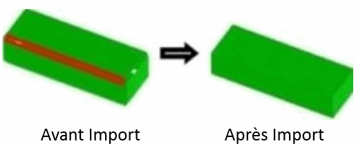

| Type de correction | Description | |
| Correction automatique |   | |

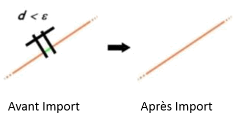

| Couture des faces libres |   | |

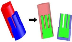

| Assemblage des solides |   | |

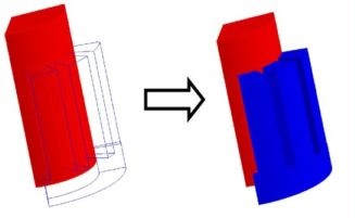

| Correction autocollision |  | |
