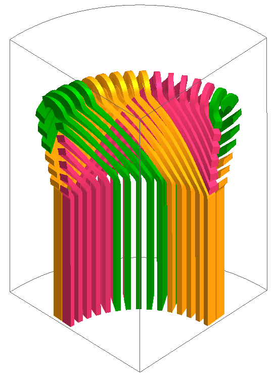

Example of a rotating machine

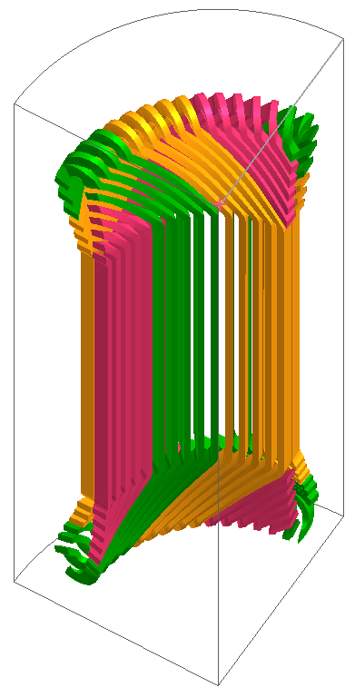

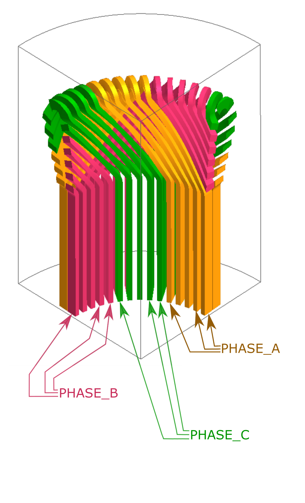

| PHASE_A | PHASE_B | PHASE_C |
| 3-phase windings of a rotating machine. There are three phases: phase A (orange), phase B (purple) and phase C (green) and one region per phase | |
| A quarter of the device is described due to a periodicity | Half a quarter of the device is described due to a periodicity and a Tangent magnetic fields symmetry |
Figure 1. Names of coil conductor regions of the rotating machine

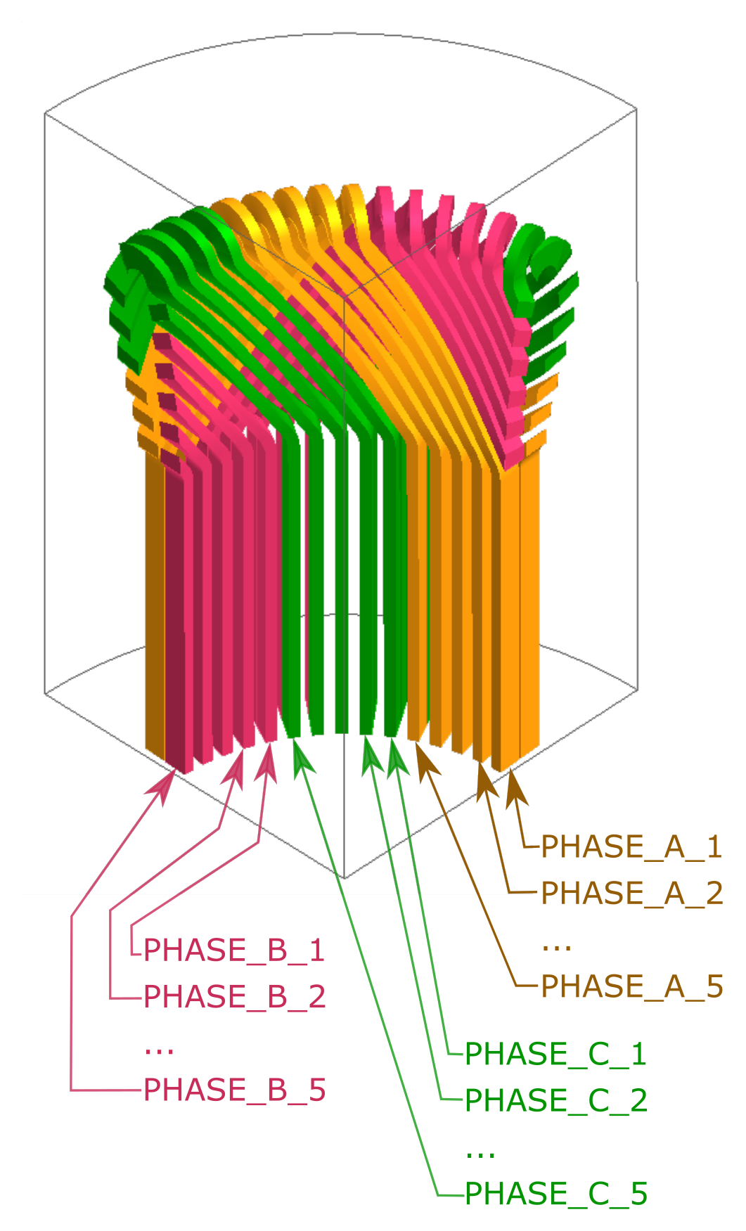

| PHASE_A_1 | PHASE_B_1 | PHASE_C_1 |
| PHASE_A_2 | PHASE_B_2 | PHASE_C_2 |
| PHASE_A_3 | PHASE_B_3 | PHASE_C_3 |
| PHASE_A_4 | PHASE_B_4 | PHASE_C_4 |
| PHASE_A_5 | PHASE_B_5 | PHASE_C_5 |
Figure 2. Names of coil conductor regions with losses and detailed geometrical description of the rotating machine

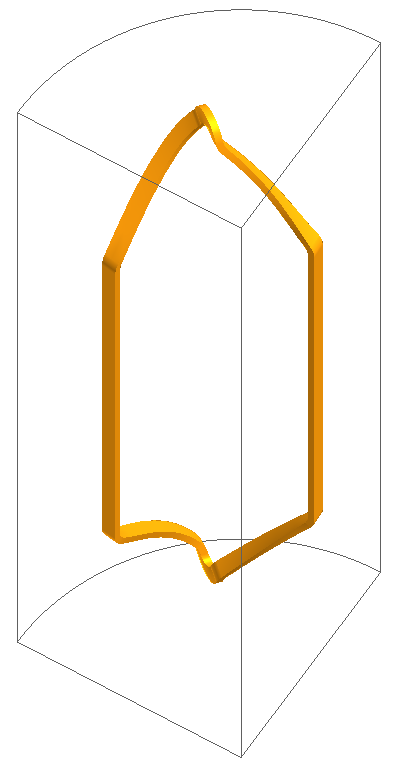

How to assign a coil conductor region to volumes when it is cut by the periodicity planes?

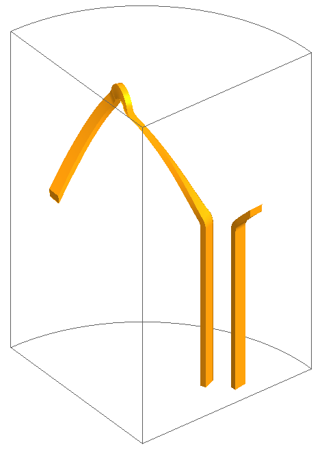

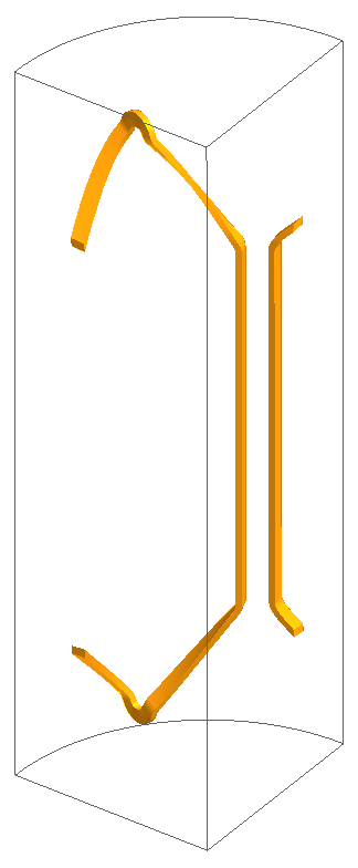

The volumes of a coil conductor region must correspond to a whole coil. When the periodicity planes cut such a region, its volumes are split into two separate groups of contiguous volumes. The two groups are linked by their periodic faces, as described in the following figures.
This section explains how to assign a coil conductor region to volumes when it is cut by the periodicity planes by one of the following commands:
- Assign regions to volumes (completion mode)
- Assign regions to volumes (modification mode)

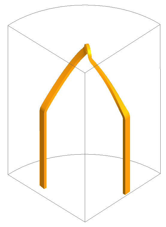

| Part of region PHASE_A. It consists of one contiguous volume | Another volume of the region PHASE_A. It is split into two separate groups of contiguous volumes, because it is cut by periodicity planes. | |
| With a symmetry plane |
| Without any symmetry plane |

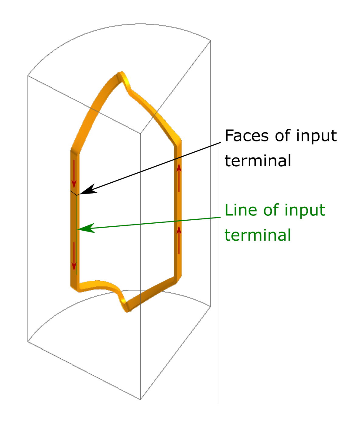

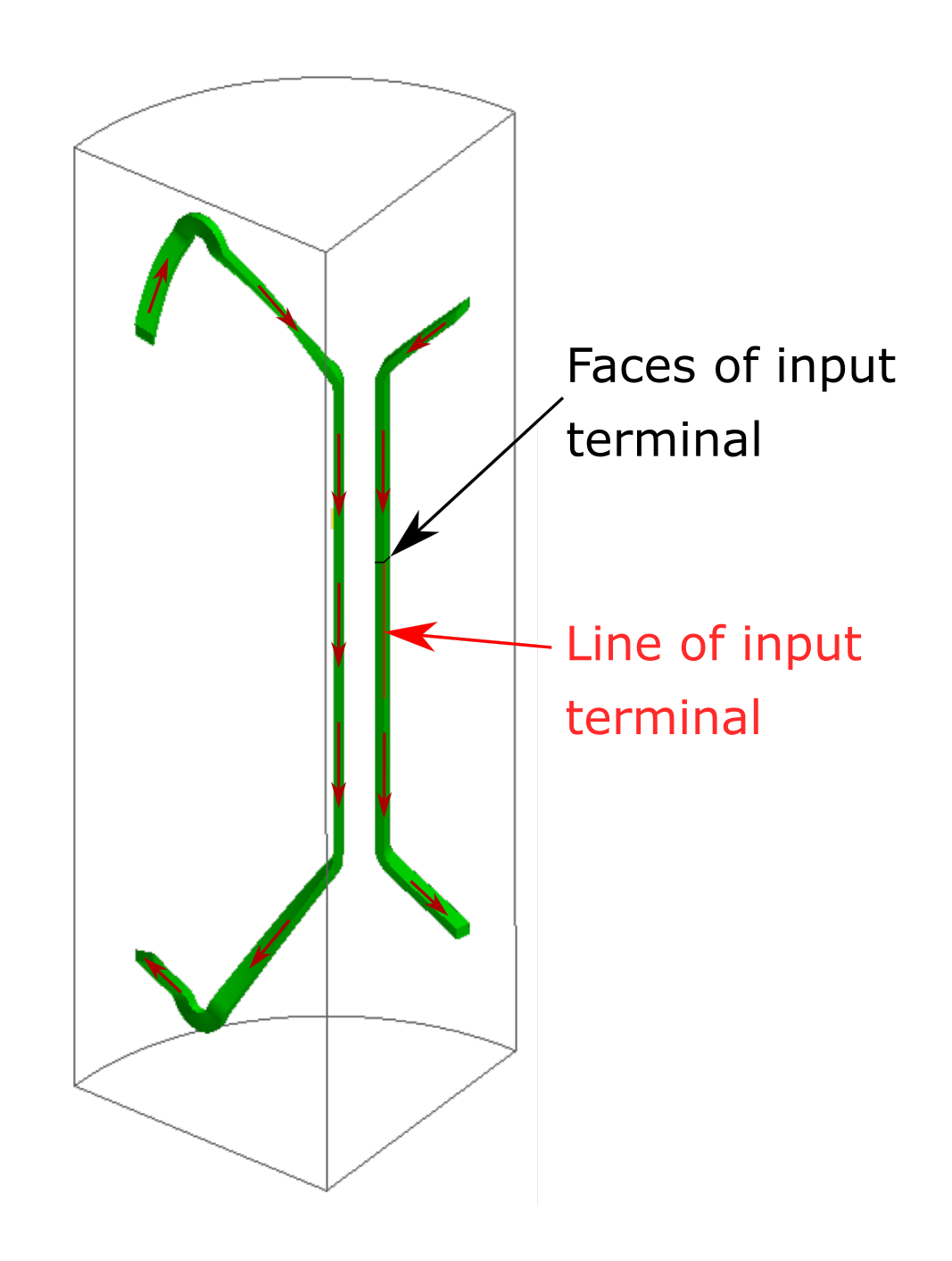

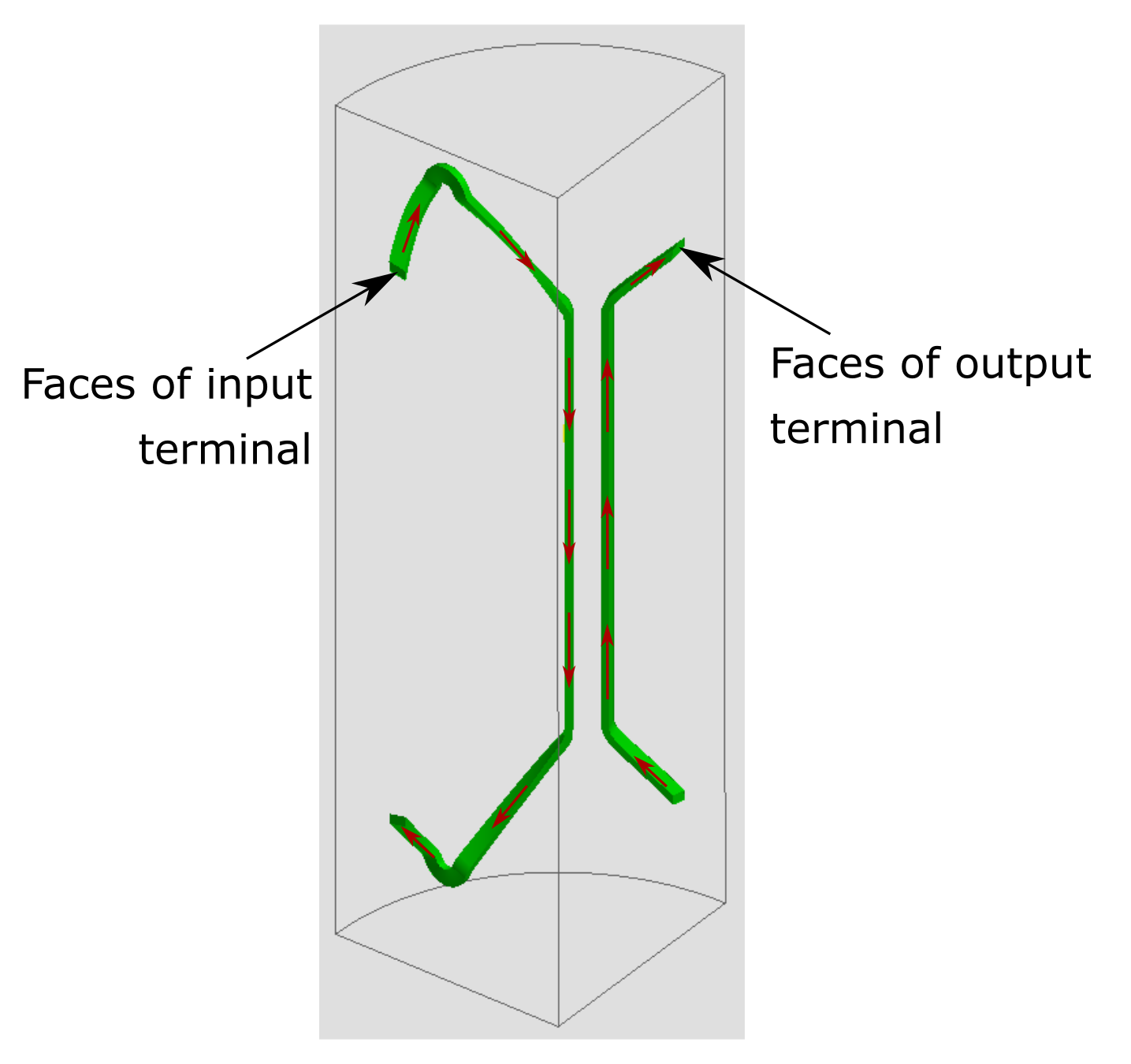

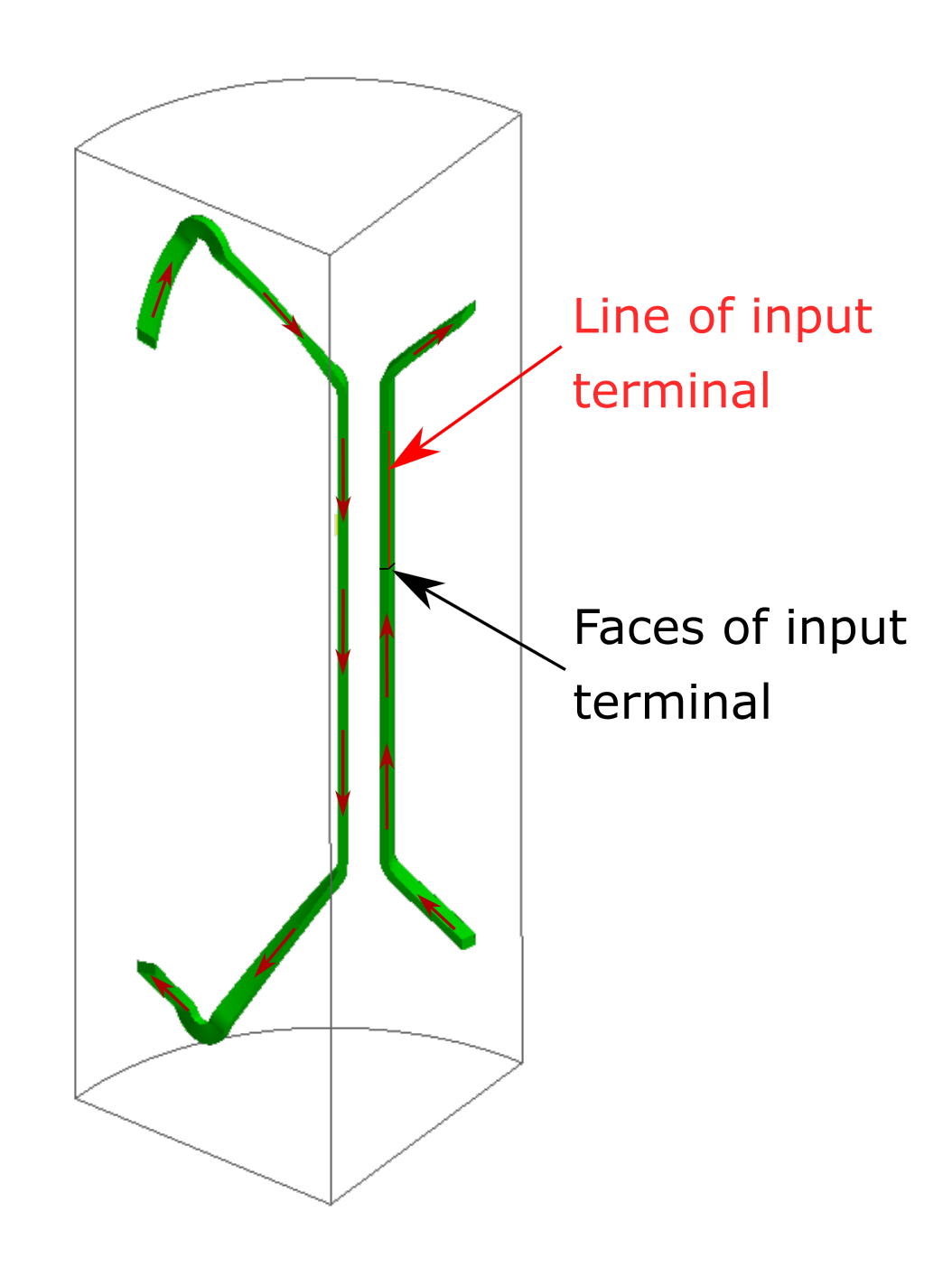

Cyclic or anticyclic periodicity:
- Select internal terminals,
- Select the faces of the input / output terminal intersecting the coil,
- Select the line indicating the side of the input terminal and the positive current direction.
| Selection of the faces and line of the input terminal of regions for cyclic periodicity | |

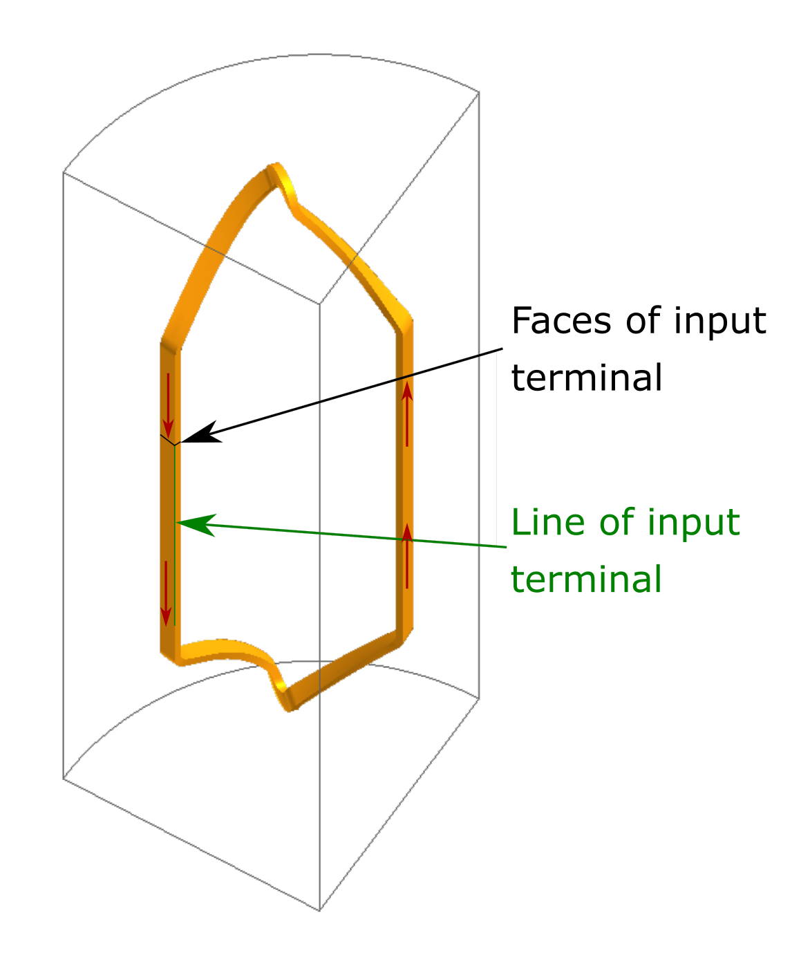

| Selection of the faces and line of the input terminal of regions for anticyclic periodicity | |
Anticyclic periodicity

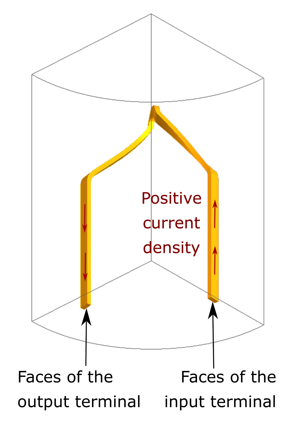

Anticyclic periodicity and “Tangent magnetic fields” symmetry:
When there is an anticyclic periodicity and a Tangent magnetic fields symmetry, the faces of the terminals to select are those located on the symmetry plane.
- If the region is not cut by the periodicity planes, for a part of region
PHASE_A:
- Select external terminals,
- Select the faces of the input terminal. They are located on the
symmetry plane,
- Select the faces of the output terminal. They are located on the symmetry plane.

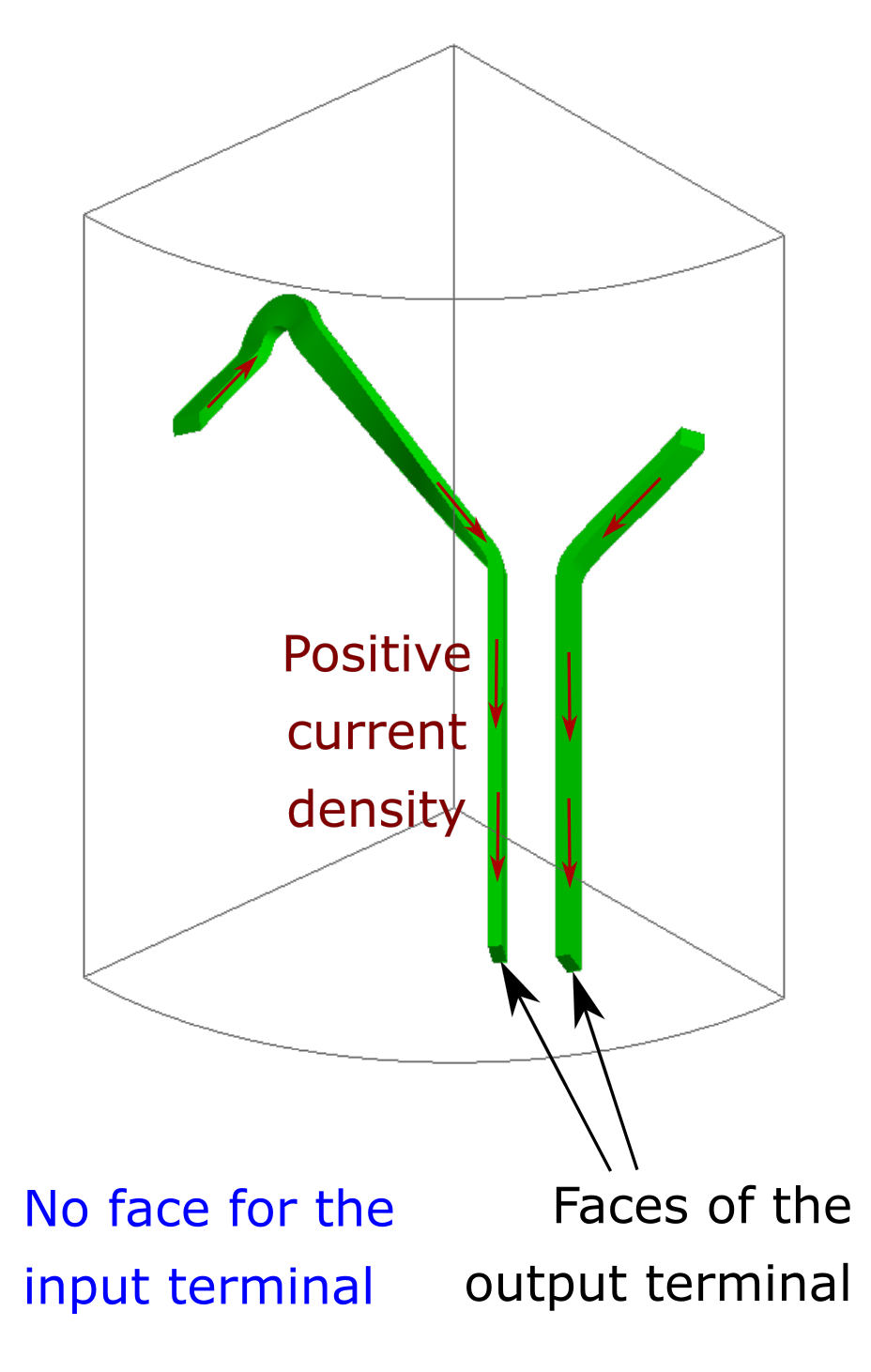

- If the region is cut by the periodicity planes and the positive current
enters the region on the symmetry plane, for a part of regions PHASE_A and
PHASE_B:
- Select the faces of the input terminal. They are located on the symmetry plane,
- Select no face for the output terminal.
comes out of the region on the symmetry plane, for region PHASE_C:
- Select no face for the input terminal,

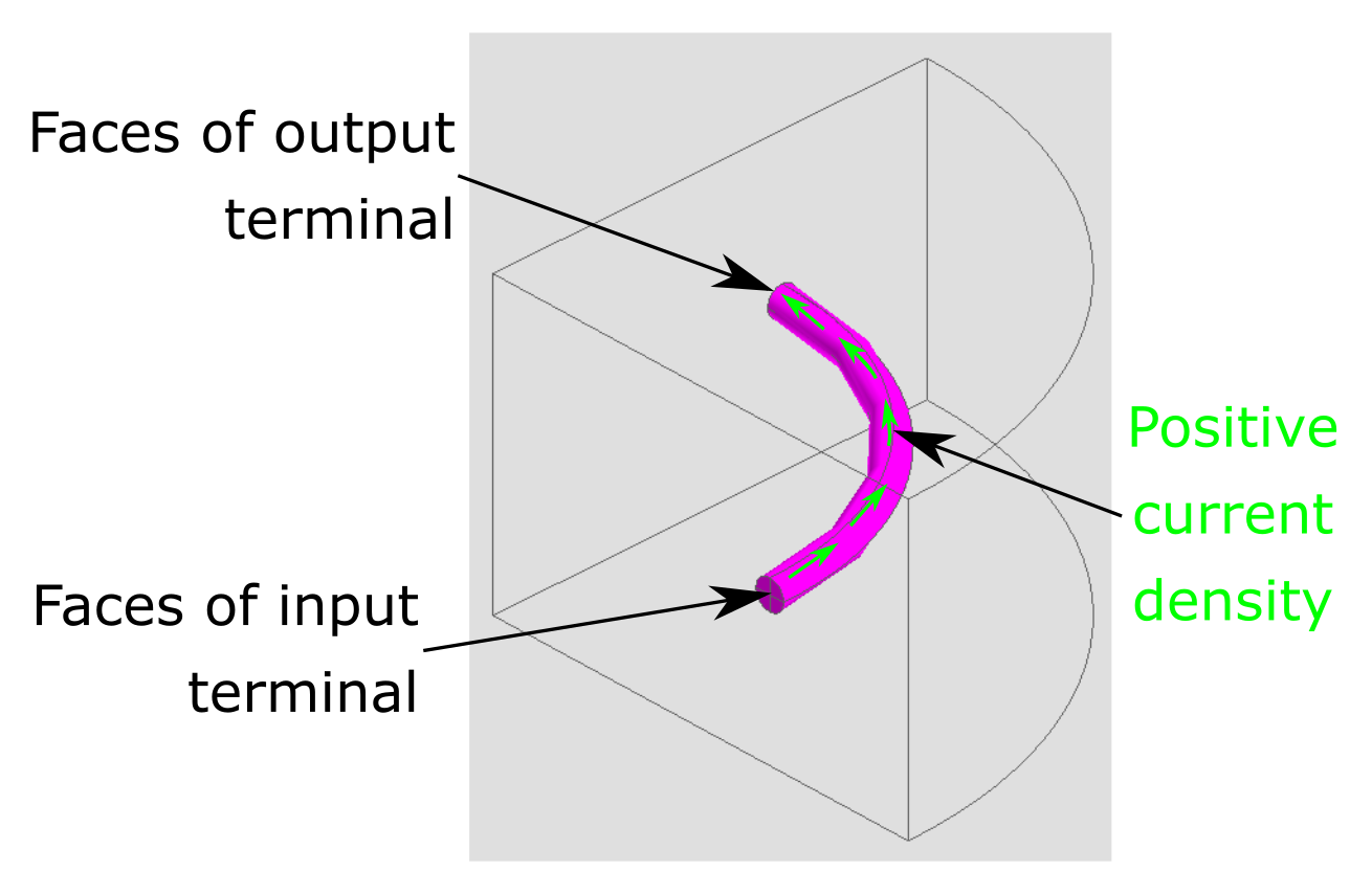

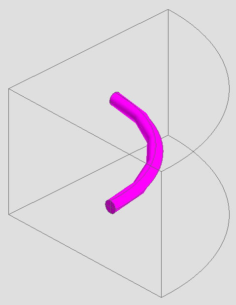

An example of such a coil conductor region is given by the ring-shaped conductor shown below (and by the coil conductor region PHASE_C in the rotating machine example considered above as well). In such cases, it is easier to create the required electric terminal on the periodicity planes, and the procedure depends on the periodicity type. These two possibilities are covered in the next two paragraphs.

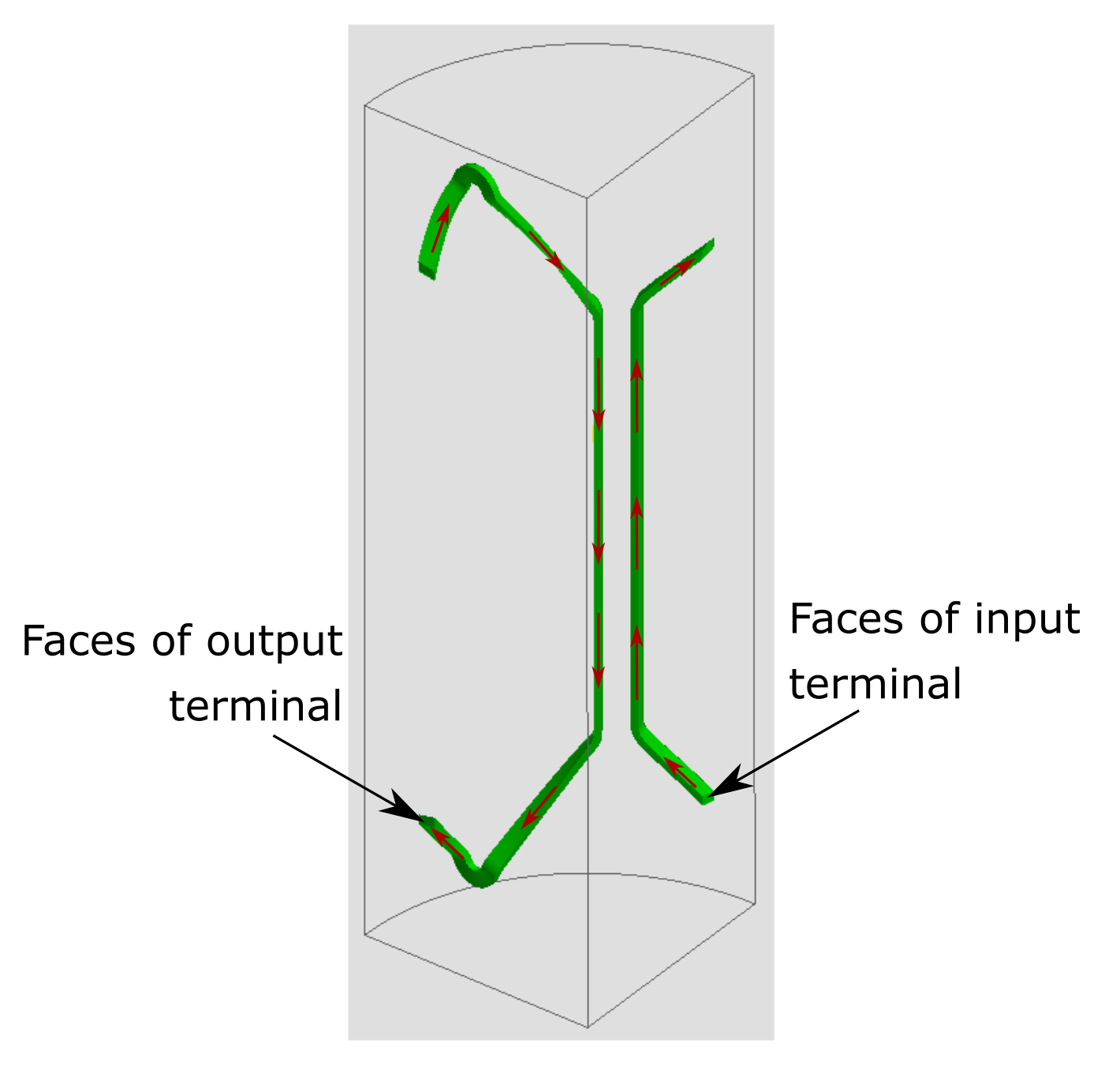

Figure 3. Example of a ring-shape coil conductor region in a FEM domain with a
90o periodicity.Cyclic periodicity

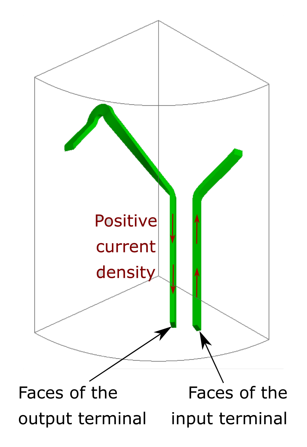

When the project has a cyclic periodicity, there are no symmetries exists and the region is cut by the periodicity planes, the faces the terminals to be selected are those located on the periodicity planes.
- select external terminals;
- select the faces of the input terminal accordingly with orientation of the current in the coil conductor region. These faces are located on a periodicity plane;
- select the faces of the output terminal. They are located on the other periodicity plane.
| Selection of the faces representing the terminals of a coil conductor region with a cyclic periodicity. | |

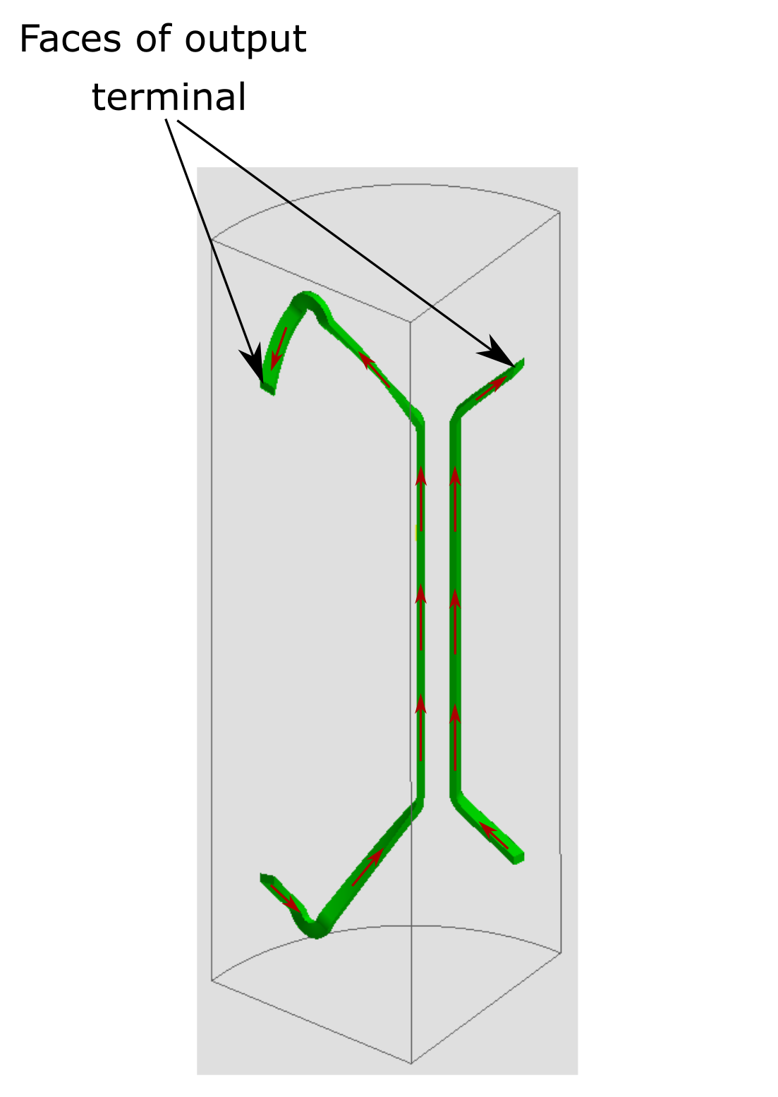

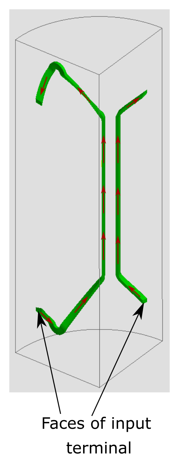

When the project has an anticyclic periodicity, there are no symmetries and the region is cut by the periodicity planes, the faces of the terminals to be selected are those located on the periodicity planes as well.
- Select external terminals.
- Accordingly with the orientation of the current in the coil conductor region, either select the faces belonging to the input terminal or the faces belonging to the ouptut terminal. In both situations they are located on the two periodicity planes.
