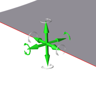

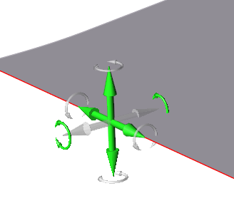

Translate or Rotate Constraints
When you create a support, translation is locked in all directions by default; you can edit individual supports to allow translation in one or more directions.
Supports applied to a point, line, or face can translate in up to three
directions.Apply a Support to a Cylindrical Hole
