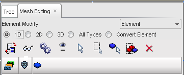

Beams, trusses and springs can be modified.
| 1. | From the Menu Bar, select Mesh Editing > Element > Modify. |
or
If the Mesh Editing panel is already open, select Element > Modify from the pull-down menu in the panel.
| 2. | Select the 1D radio button. |
| 3. | Click |
or
In the element list, click one element and click
to display it in blue in the graphic window.
| 4. | Click |
or
Click
to modify the element location:
| • | In the graphic window, pick one node of the element. |
| • | Next, pick another node to define the new node location. |
| 5. | Click Save to save the element modifications; or |
Click Cancel to cancel the element modifications.
| 6. | Click Close to close the menu. |
