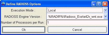

Just after the variables and responses are defined, it is necessary to also define the version of RADIOSS to be used, the number of processors, and how the computations should be submitted.
To define the computational options:
| 1. | From the Menu Bar, select Process, then Study, then Optimization, then RADIOSS Computational Options. |
The following window appears:
| 2. | Select an Execution Mode. |
| 3. | Select the RADIOSS version to use. |
| 4. | Enter the Number of Processors to use. |
| 5. | Click the Ok button. |
