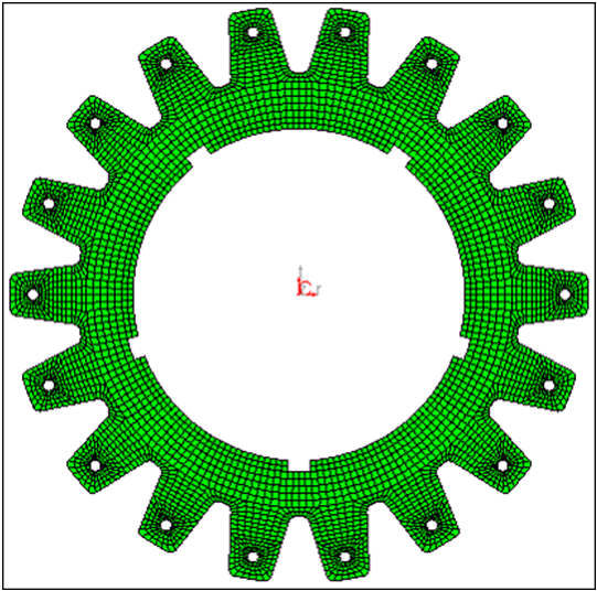

Create Symmetries
In this step, you will create symmetries.
- From the menu bar, select to enter the Symmetry panel.
- Switch the symmetry type to cyclical.
- Switch the symmetry angle from 180 degrees to set freq.
- Set the # of cycles to 18.
- Click syst.
- Select the center point of the gear.
- Click domains >> all.
- Click create.
- Click return.
