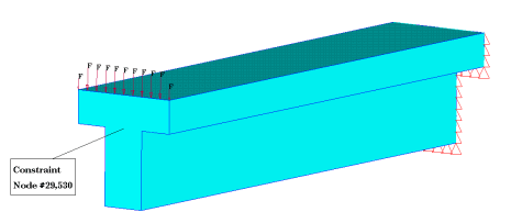

The maximum displacement at the beam tip is limited, and the 1st and 2nd eigen frequencies have a lower bound. Two subcases are defined; subcase 1 is the static load case, subcase 2 is the eigenmode analysis.

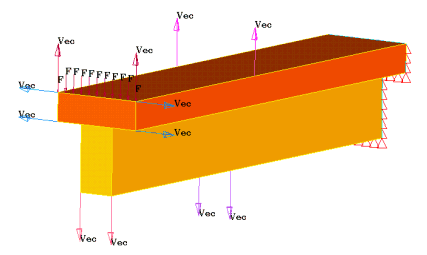

Figure 2. Cantilever Beam; Design Elements and Design Variables

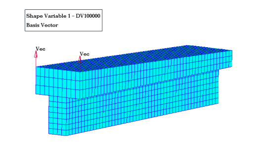

Figure 3. Cantilever Beam; Perturbed Shape Number 1

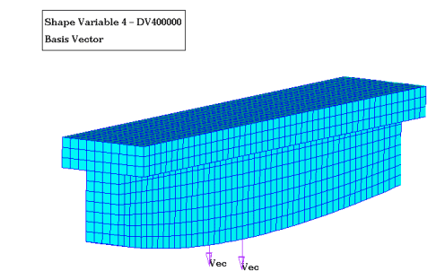

Figure 4. Cantilever Beam; Perturbed Shape Number 4
The perturbation vectors need to be provided in the format of the DVGRID cards using AutoDV (part of HyperMesh). These cards can be generated automatically. The output of AutoDV also includes the design variable definition DESVAR. The output file Beam_shape.dat can be incorporated into the Bulk Data section of the OptiStruct input deck via an include statement.

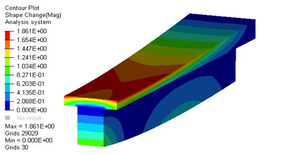

Figure 5. Cantilever Beam; Final Shape
