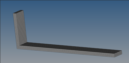

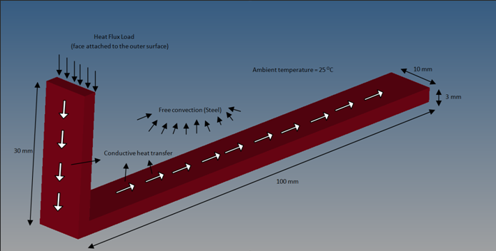

An extended surface heat transfer fin made of steel is illustrated in Figure 1. To meet certain structural design requirements, the fin is bent at 90° at approximately a quarter of its length.
Figure 1. Extended Surface Heat Transfer Fin for Convective and Conductive Transient Heat Transfer

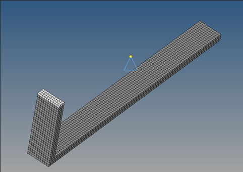

Figure 2. Heat Exchanger Fin Model for Transient Heat Transfer Analysis

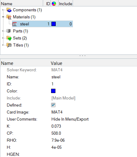

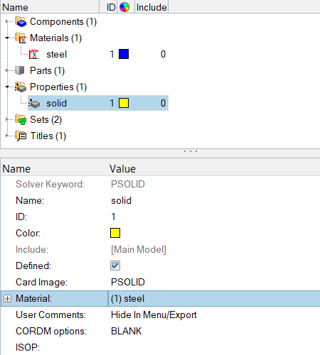

Create Thermal Material and Property

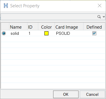

Link Thermal Material and Property to the Structure

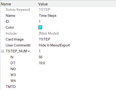

Create Transient Heat Transfer Analysis Time Steps

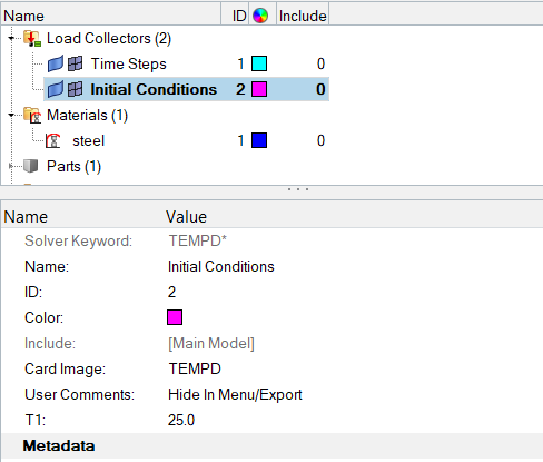

Create Transient Heat Transfer Analysis Initial Conditions

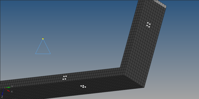

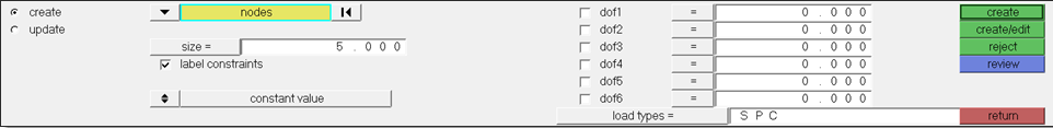

Apply Ambient Temperature Boundary Conditions

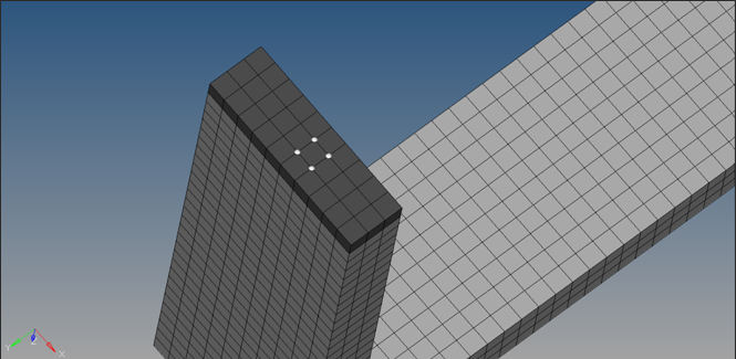

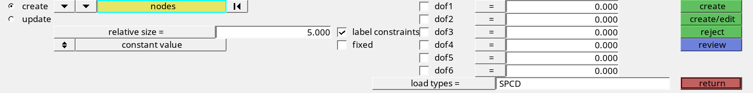

Ambient temperature thermal boundary conditions is applied on the model by creating specific load collectors for each. The ambient temperature is controlled using an SPCD entry, as this will allow an ambient temperature variation over time to help mimic such physical requirements (if any).
Create a Time-variant Ambient Temperature

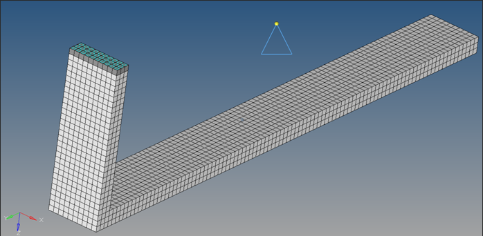

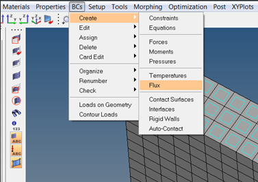

Apply Heat Flux Load

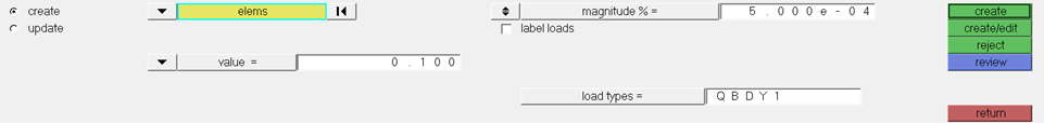

Ambient temperature thermal boundary conditions have been assigned to the model and heat flux load from the outer surface of the engine (to which the fin is attached) is applied on the model. A time-varying heat flux load of 0 to 0.1 W/mm2 from 0 to 500 seconds is used for the analysis of this fin. This load is applied on the model by creating specific load collectors for the corresponding TLOAD1, QBDY1 and TABLED1 entries similar to the procedure used for the ambient temperature SPCD definition.
Create a Time-variant Linearly Increasing Heat Flux Load
Checkpoint
The QBDY1 flux load and its corresponding table are linked to the previously created TLOAD1 entry.

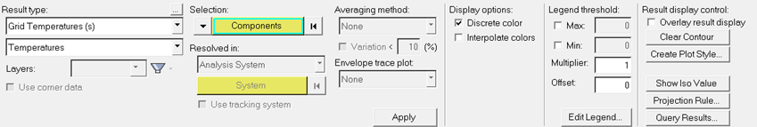

View Results
Checkpoint

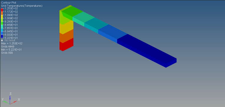

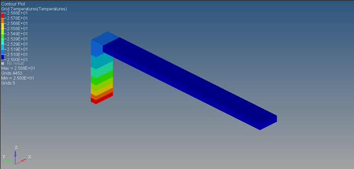

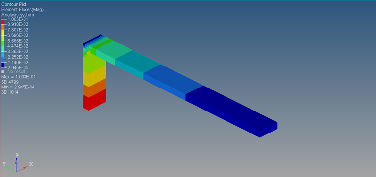

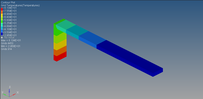

In Figure 26, this is the grid point temperature plot after 500 seconds. The system is input a linearly increasing heat flux from 0 to 0.1 W/mm2 from 0 to 500 seconds respectively. Therefore, a physical correlation can be the effect of starting an IC engine to full capacity wherein the flux transmitted to the outer surface linearly increases with time. Note that the flux patterns in actuality may be different and may fluctuate based on the duration of the power cycles. The maximum temperature of 81.3°C predictably occurs at the elements closest to the heat flux loading site and the minimum temperature of 29.5°C occurs at elements farthest from the heat source.
Figure 28. Grid Temperature Contour Plot after 500 Seconds - WITHOUT FREE CONVECTION
Figure 29. Contour Plot of Element Fluxes after 500 Seconds
