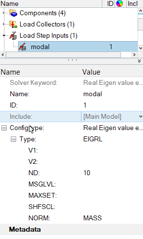

Create modal Load Step Input
This can be done using the Load Step Inputs panel and the create subpanel.
  1. In the Model Browser, right-click and select Create > Load Step Inputs.
  2. For Name, enter modal.
  3. Set Config type, select Real Eigen value extraction.
  4. For Type, select EIGRL.
  5. For ND, enter 10.
    ND specifies the number of modes to extract.
    os_1110_13_01

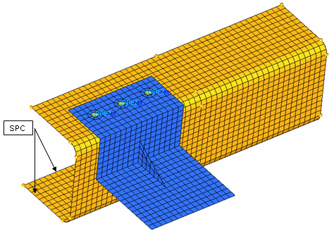

Apply Constraints (OptiStruct SPC) on the Channel
  1. Expand the Component folder in the Model Browser.
  2. Click the geometry icon entityGeometry-24 next to the channel component to turn the geometry display on.
  3. Click the Isometric View icon viewAxisOrientationIso-24 in the toolbar.

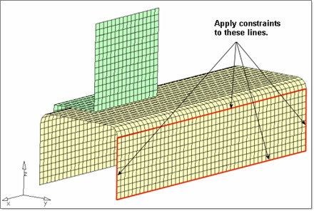

    You are going to create the SPC constraints on the nodes along the lines on the perimeter of the channel's bottom surface, as shown in the image below.
    rd1110-02
    Figure 3. Apply Constraints on the Channel
  4. Click BCs > Create > Constraints to open the Constraints panel.
  5. Switch the entity selector to lines.
  6. Select the six lines on the perimeter of the channel's bottom surface.
    To view the selected lines clearly, switch to Transparent Elements mode, as shown below:
    rd1110_transparent
    Figure 4.
