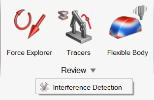

To use Interference Detection:
Open the Review section on the Motion ribbon, then
select Interference Detection.
The guide bar appears.

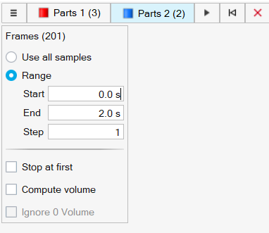

A filtering window appears.
Filter the search.
To
Do this
Notes
View the number of frames used in the search
In the filtering window, next to
Frames, refer to the number in
parentheses.
Search all steps in the analysis for
interferences
In the filtering window, select Use all
samples.
Specify when to start and end the search
Range, then enter values for
Start and
End.
Specify steps to skip over in the search
Range, then enter a value for
Step.
Tip:
Setting a specific time range and
Step to skip over can help
speed up the detection process by not searching
redundant interferences.
Stop the search at the first detected
interference
In the filtering window, turn on Stop at
first.
View maximum interferences and display volume in the
Results Review window
In the filtering window, turn on Compute
volume.
Tip:
To speed up results, turn off Compute
volume.
Exclude interferences with volume values of 0 from your
search
In the filtering window, turn on Ignore 0
volume.
Tip:
Parts that have coincident (or tangent) faces will
return a 0 volume interference. The
Ignore 0 volume option can
be used to disregard all instances of coincident
faces.
Interferences involving parts that have 0 volume
(like sheet parts) will result in an interfering
volume of 0, even though it may be a legitimate
occurrence of interference. To see interferences
involving 0 volume parts, turn on Compute
volume.

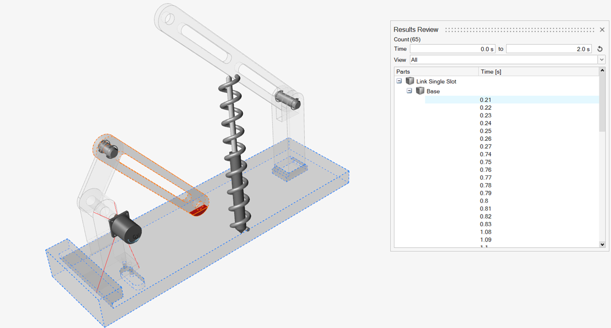

In the guide bar, click to apply the filters and run the search.

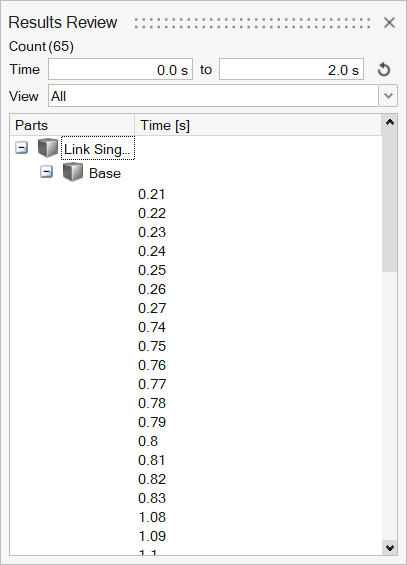

The Results Review window appears.
Click + next to part names to show the list of
interferences and their corresponding times.
Review the results.
To
Do this

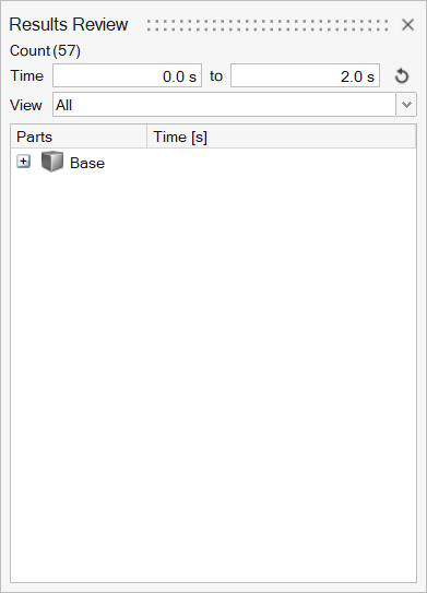

View the number of detected interferences
In the Results Review window, refer to the
Count section. The number in
parentheses shows the number of detected interferences based
on the search criteria used.
View detected interferences in the model at a specific
time
In the Results Review window, click a Time
[s] entry in the list of detected
interferences. The corresponding instance of the
interference result is highlighted in red in the modeling
window.
