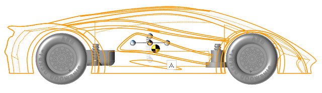

Center of Gravity (COG)
Use the Center of Gravity Constraint (COG) tool to apply, reposition, and set upper and lower bounds for a center of gravity constraint. COG constraints are used to limit the position of the center of gravity while running a topology optimization.

Figure 1. Car model with a center of gravity constraintApply a Center of Gravity Constraint
Select parts and click the Create button to create center of gravity constraints.

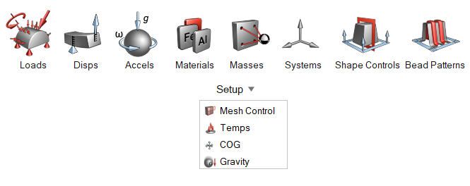

Open the COG tool:
On the Structures ribbon, next to
Setup, select
. A dropdown menu appears.
- Select the COG tool.
Setup, select
- Select one or more parts and click the Create button to create a center of gravity constraint.
Click the Move
icon to reposition the COG constraint if
needed.
- Click an axis on the manipulator and select the check boxes to enable upper and lower bounds for the constraint.
