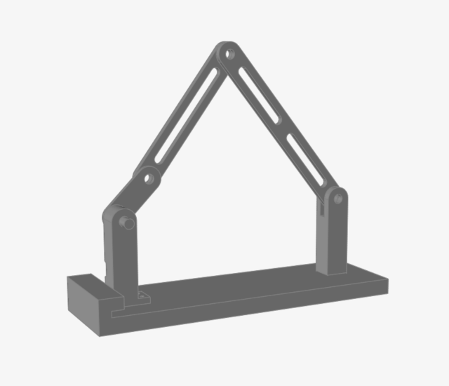

Open the CAD model
- Press F7 to open the Demo Browser.
Double-click the M01_FourBar.x_t file in the Motion folder
to load it in the modeling window.

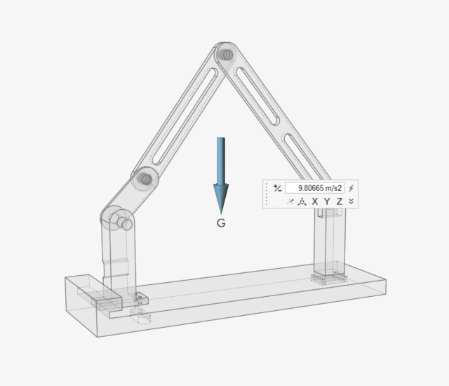

Inspect the Gravity Direction
Open the Gravity tool:
On the Motion ribbon, next to
Forces, select
. A dropdown menu appears.
Select the Gravity tool.
By default, the gravitational acceleration (G) is set to 9.80665 m/s2 in the -z direction.
Forces, select
Notice that a vector is displayed which indicates the direction of
gravity.

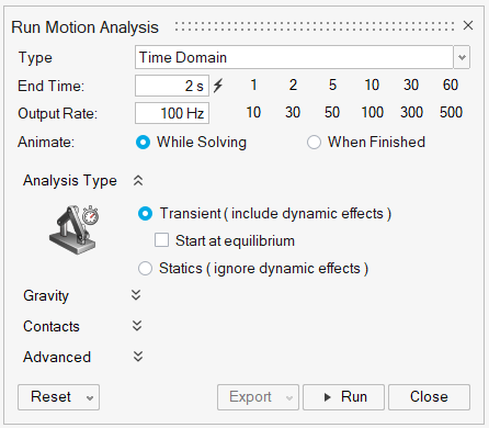

Change the Run Settings and Rerun the Analysis
Hover over the Analyze Motion tool, then click the
Run Settings icon to open the Run Motion Analysis
window.
- Change the Output Rate to 100 by entering the value in the field or clicking the 100 button.
Click Gravity and verify that it is set to
Yes.
This is the default setting for a motion analysis.
- Close the Run Motion Analysis window.

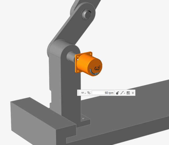

Add a Motor to Drive the Mechanism
Select the Motors tool.
Click the Cen (center) snap point of the Link Crank part
to define the shaft connection point.
The feature turns red.
Select the Mount Crank as the base connection.
The motor is created, and a microdialog appears with the Speed set to 60 rpm.

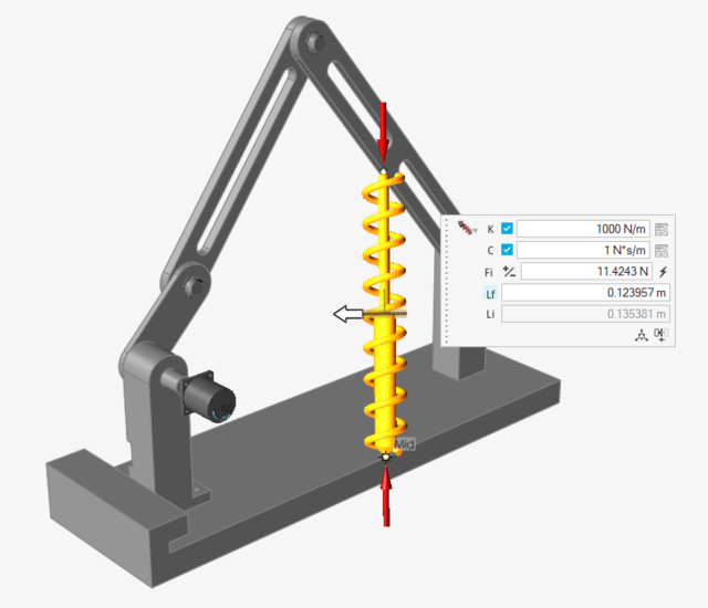

Add a Spring-Damper Force
Select the Coil Spring tool on the Springs icon.
Click the Mid (middle) snap point of the Link Dual Slot
part.
The selected feature turns red.
Select the Base part.
A coil spring appears and the microdialog shows the default settings.
Click and drag the end point manipulator at the bottom of the spring to
relocate it to the Mid snap point of the Base part.
In the microdialog, change the K stiffness value to
2500 N/m.
Click and drag the white arrow manipulator to reduce the spring Diameter
slightly.
Click the Run Settings icon.
Change the End Time to 2 s by entering the value in the
field or clicking the 2 button.
- Close the window.
