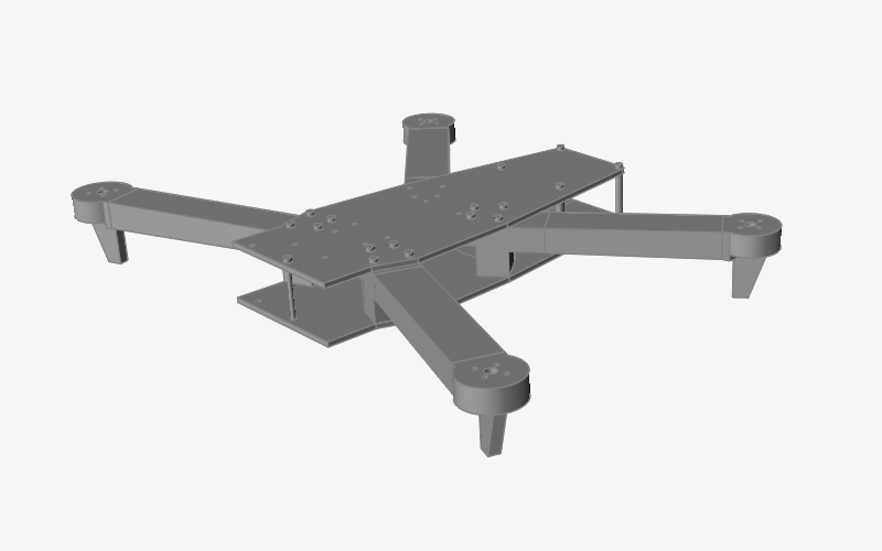

![](../../../images/figures/inspire/quad_overview.png)
Open the Quadcopter Model
- Press F7 to open the Demo Browser.
Double-click the Quadcopter.stmod file to load it in the
modeling window.

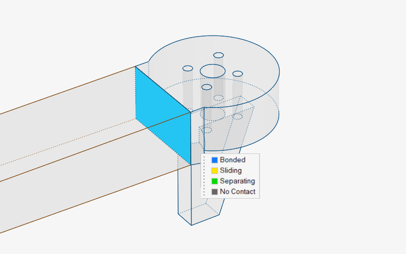

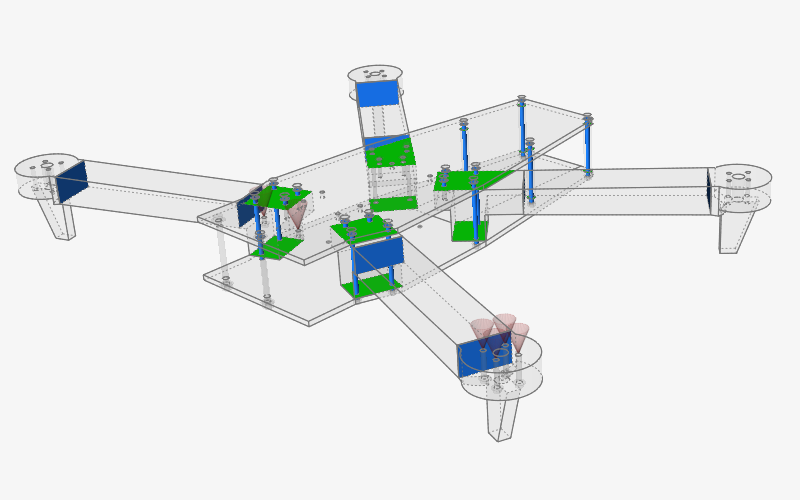

View Contacts

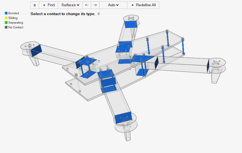

Select the Contacts tool on the Structure ribbon.
Observe as the guide bar appears, and the tool automatically finds locations
where parts are in contact.
The number of contacts found is displayed in a counter above the Contacts icon.
Bonded contacts are shown in blue, and contacting contacts are shown in green. By default, if there are fasteners or joints connecting two neighboring parts together, they are assumed to be Contacting; otherwise, they are set to Bonded. In this example, there are no fasteners or joints present, so all of the contacts are assumed to be bonded.

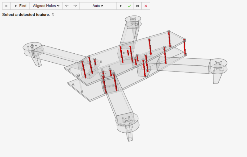

Find Aligned Holes
Now let's start creating some fasteners to connect parts that are in contact.
Select the Fasteners tool on the Structure ribbon.
where fasteners can be placed and highlights them in red.
Make sure that Aligned Holes is selected on the guide
bar. This will filter the search results so that only aligned holes on
neighboring parts are found, rather than single holes.
The number of aligned holes is displayed in a counter above the Fasteners icon.
Make sure that Auto is selected on the guide bar.
When Auto is selected, Inspire will automatically place nuts and bolts in through holes and screws in blind holes when fasteners are created.

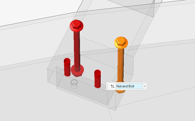

Create a Nut and Bolt
Zoom in on the front of the quadcopter.
Note that the existing geometry in this set of aligned holes is now
transparent.
When we create a fastener at this location, the original geometry will be hidden and configured off, meaning it will no longer be included in analysis and optimization calculations.

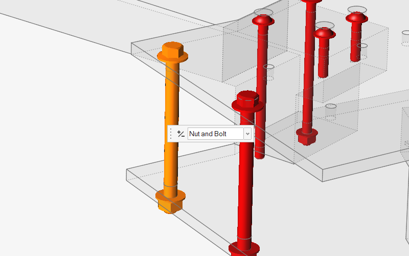

Click on one of the holes to create the fastener.
Since this is a through hole, Inspire automatically creates a nut and bolt.
Add Fasteners

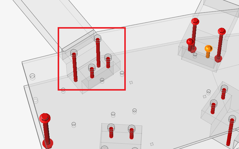

Pan and zoom in on the arm of the quadcopter shown below:
Click on the top two holes.
Inspire automatically creates nuts and bolts, as these are through holes.
Click on the bottom two holes.
Inspire automatically creates screws, as these are blind holes.

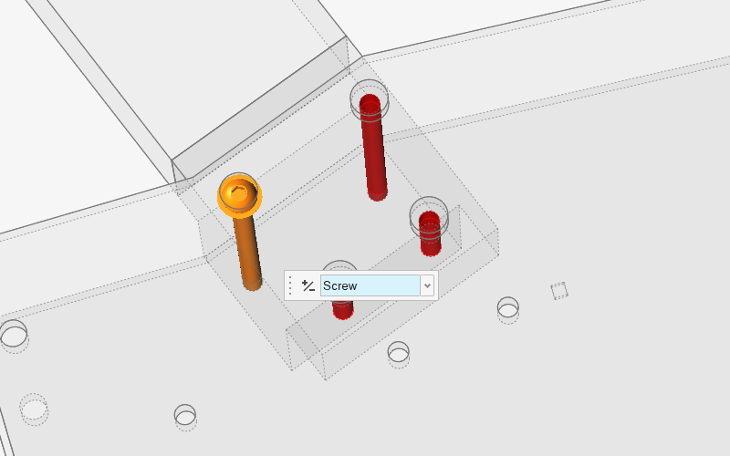

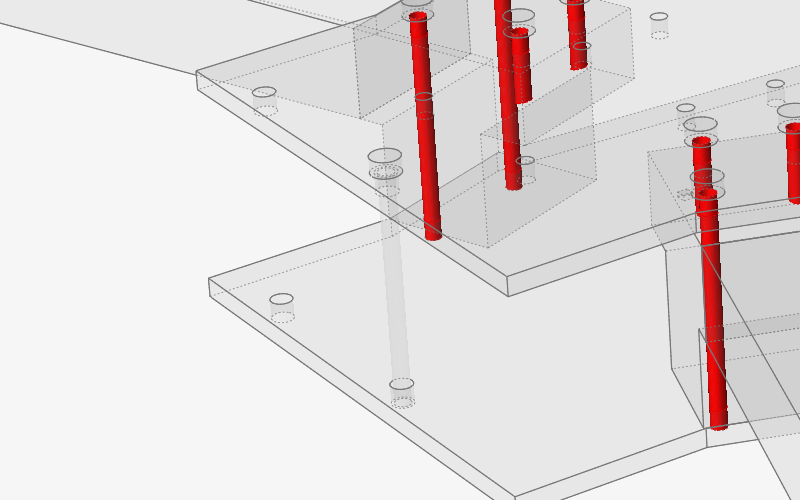

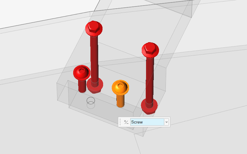

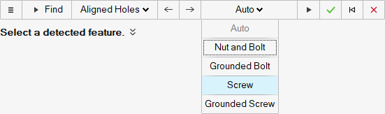

This time, we want to override the automatic settings and create a screw in a
through hole. To do this, click Auto on the guide bar and
select Screw.
Click on the hole shown below to create the screw.
Note how there is no nut on the underside of the screw we just created, while
there is on the underside of the bolt.

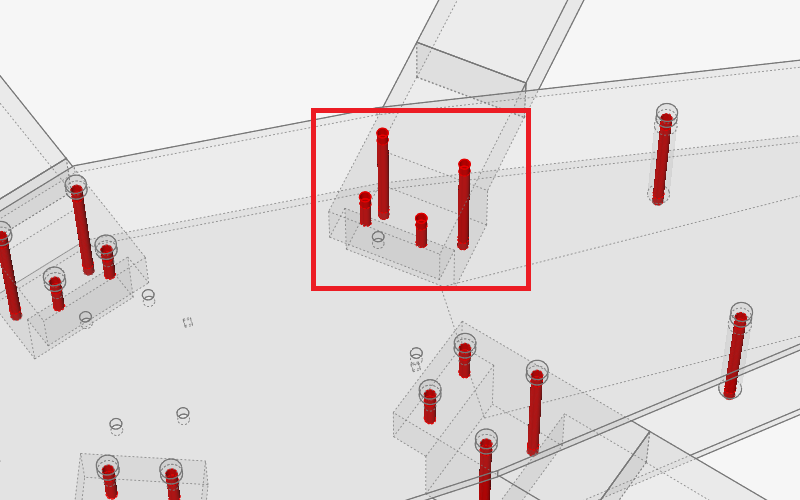

Automatically Create Fasteners
Now let's quickly create fasteners in the rest of the aligned holes.
Click Screw on the guide bar and select
Auto.
Click the Play button on the guide bar.

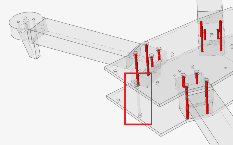

Inspire automatically places nuts and bolts in through holes and screws in blind holes.

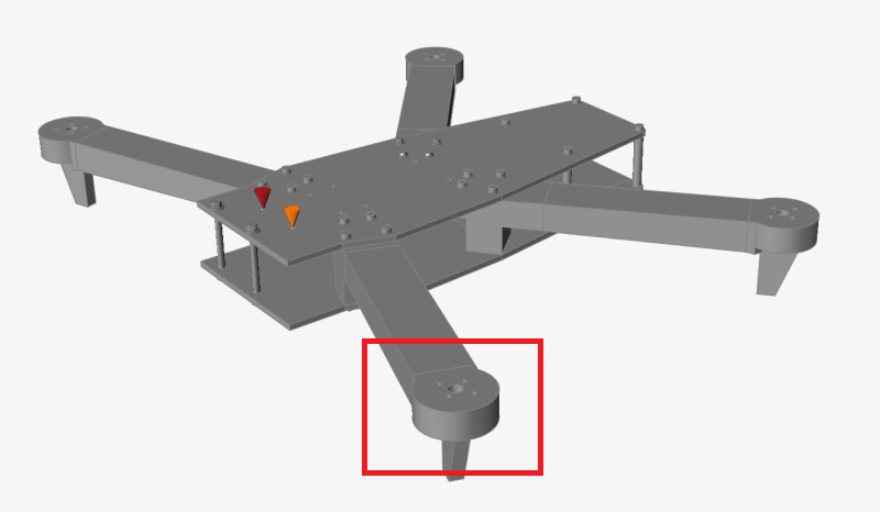

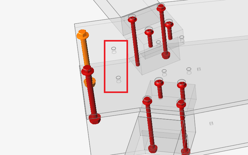

Note that no fastener was created at the location shown below, since
Inspire did not recognize the holes as aligned.
To manually create the fastener, select the inner surface of each hole, then
click again to create the nut and bolt.

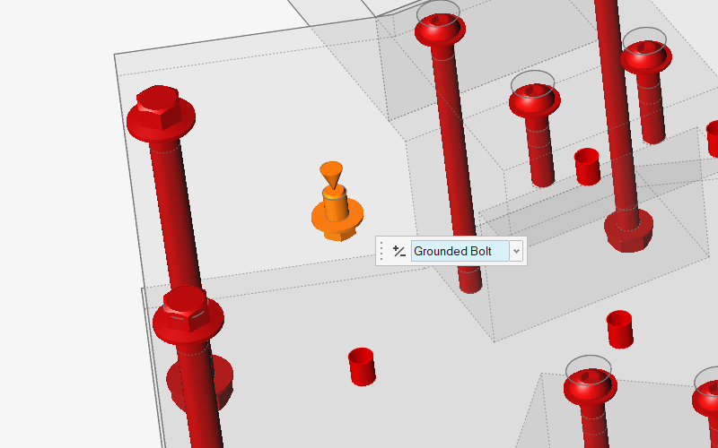

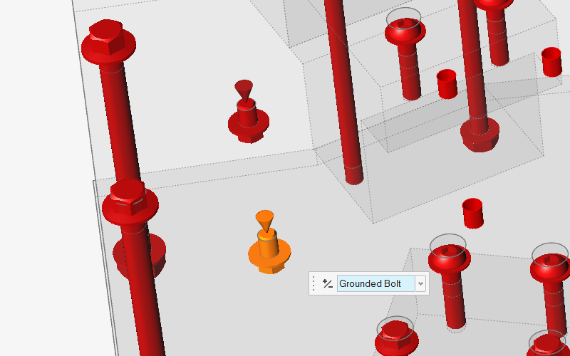

Create Grounded Bolts
Next, let's create a few additional bolts that are grounded.
Click Aligned Holes on the guide bar and select
Single Holes.
For single holes, Inspire will automatically create nuts and bolts by default.
Pan and zoom in on the two holes shown below:

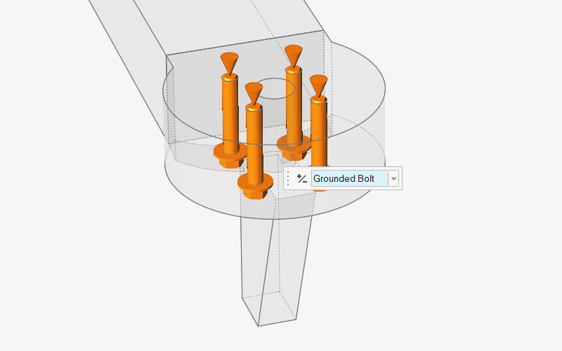

Click the top hole to create a grounded bolt, then click the
+/- button on the microdialog to reverse the
direction.
Repeat to create and reverse the direction of the second bolt.
Your model should look like this:
Pan and zoom in on the location shown below:
Create four more grounded bolts in the outer holes.
Box select the bolts and click the +/- button on the
microdialog to reverse the direction of all four bolts.

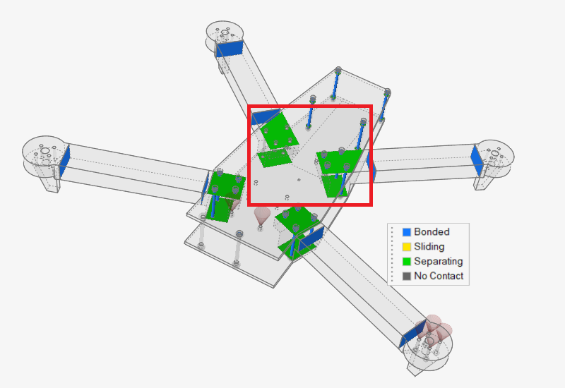

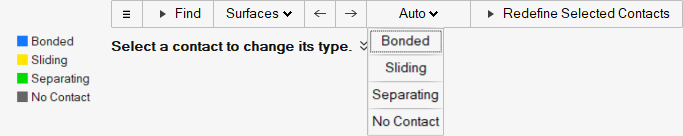

Redefine Contacts

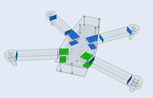

Zoom out and select the Contacts tool.
Note that now, locations where parts are connected using fasteners appear
green, indicating that they are Contacting rather than Bonded.
If needed, you can select individual contacts and change their type.
For example, hold down the Ctrl key and select the four green contacts highlighted below:
Click Auto on the guide bar and select
Bonded.
Click Redefine Selected Contacts on the guide bar.
The selected contacts are now bonded and appear blue.
Click the arrow keys on the guide bar or keyboard to move from one contact to
another on your model.
Click a contact to select it, then select a different option in the microdialog
to change the type.
