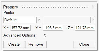

Configure the Printer Bed

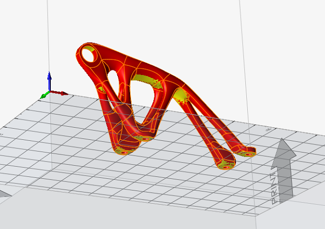

Create the printer bed and orient the part in the bed.

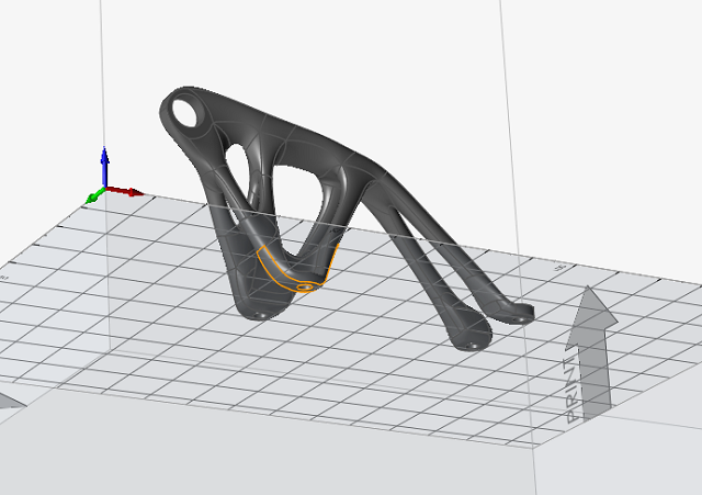

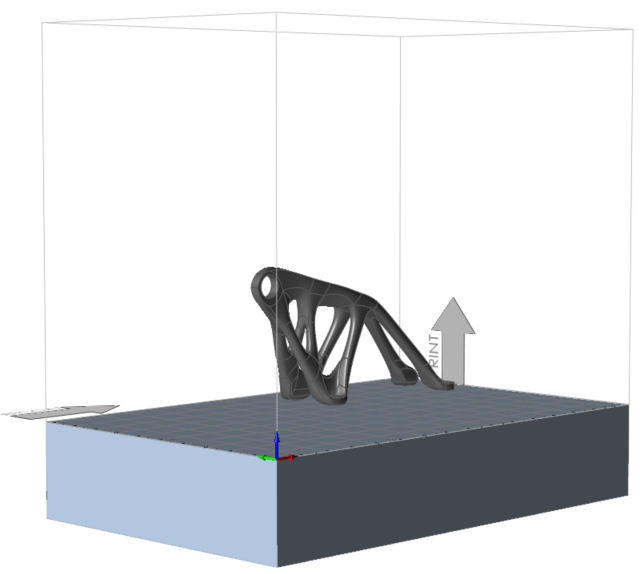

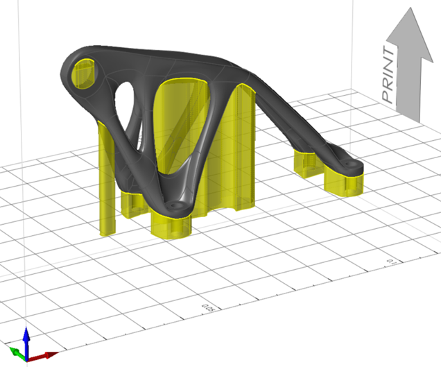

Orient the Part
You have multiple options to orient your part on the printer bed. The best option depends on the support and post-processing requirements for the part. Generally, the best orientation occurs with the fewest number of undercuts and supports.
