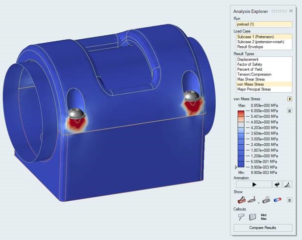

![](../../../images/figures/inspire/pretension_example2.jpg)
Figure 2. Results showing automatically generated load case: Subcase 1
