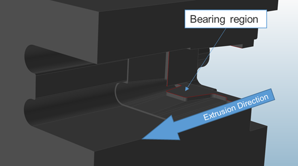

The bearing is the last point of contact in the extrusion die where the workpiece takes the final desired shape. The bearing region is a critical part of the extrusion die, as it controls the metal flow through the die.

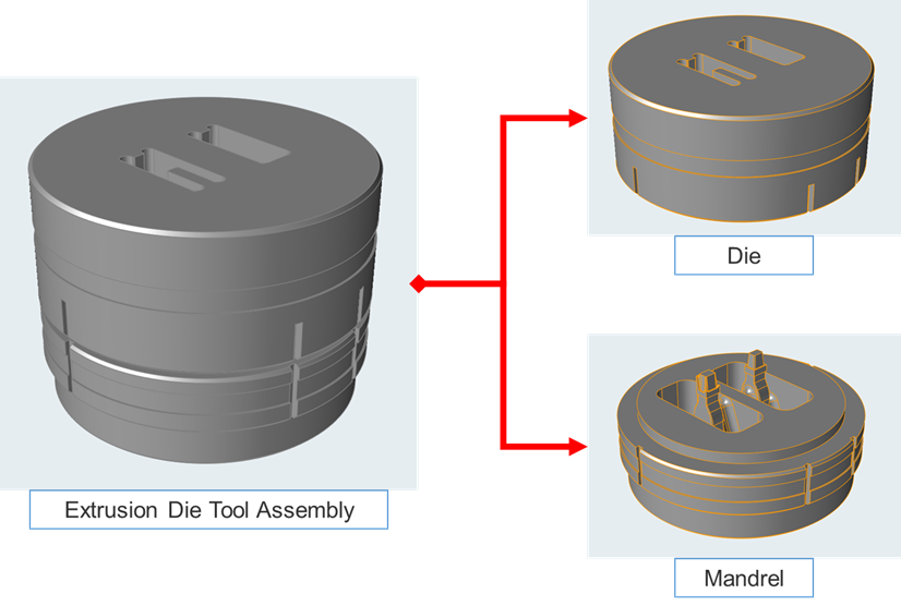

Typical Die Assembly containing - Die and Mandrel:

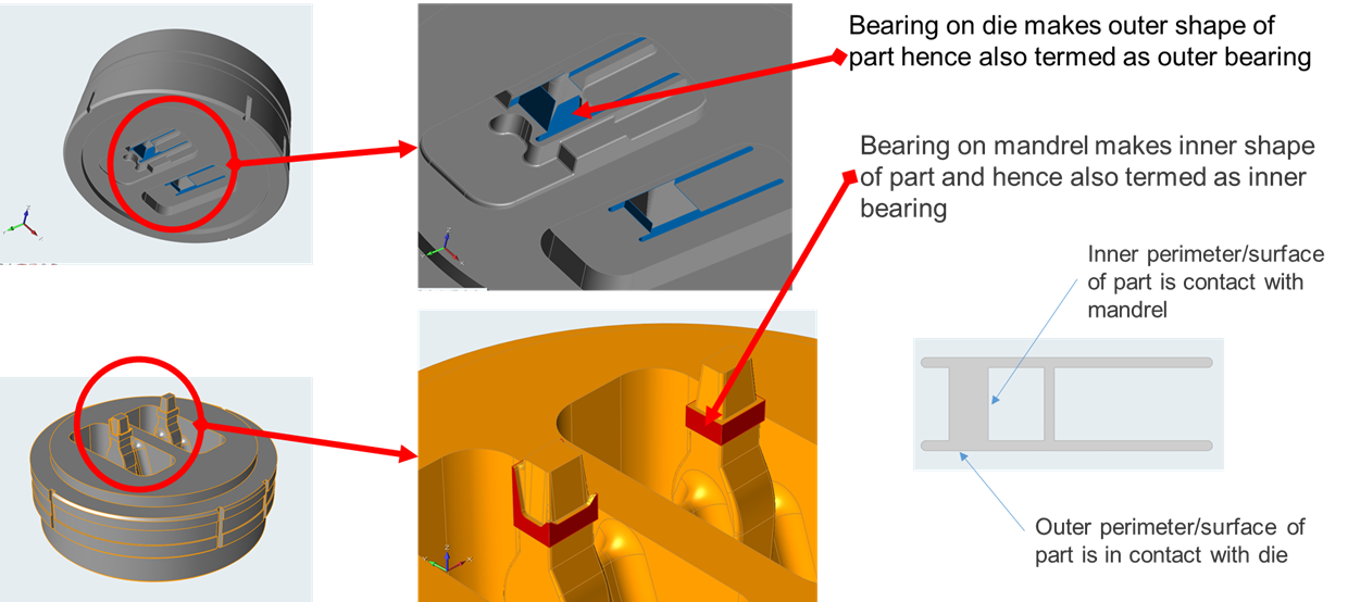

Bearing on Die and Mandrel:
- The bearing on the die makes the outer shape of the part, hence they are also called outer bearings.
- The bearing on the mandrel makes the inner shape of the part, hence they are
also called inner bearings.
