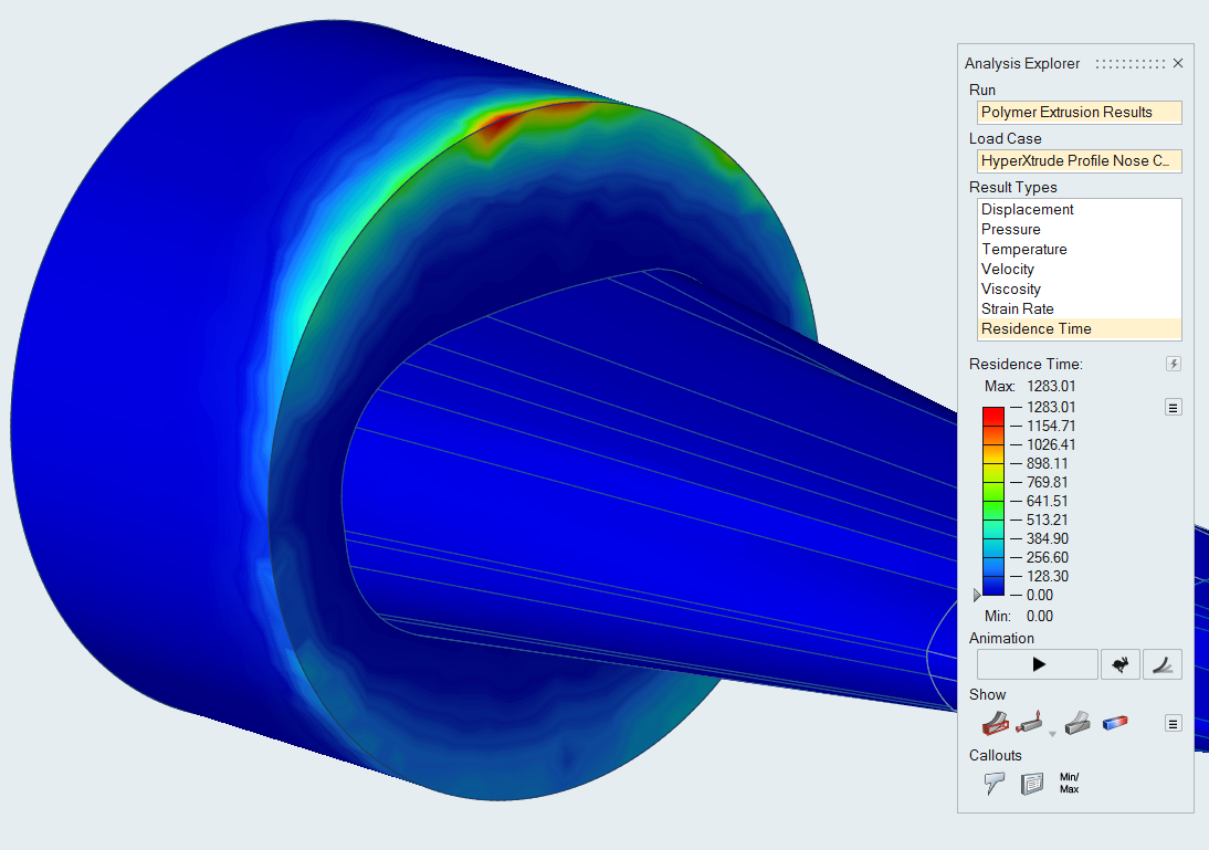

- Load results and plot Residence Time. Results below show Residence time for
a mono-polymer extrusion die.
- In this model, maximum residence time is 1283 sec (21 mins) near
corners as seen below image.

- Now review residence time at exit face to know what is maximum residence
time.
- Use Callouts function to review residence time values at few
critical locations.
critical locations.
- From figure above, the maximum value is about 315 sec (5.3 mins).

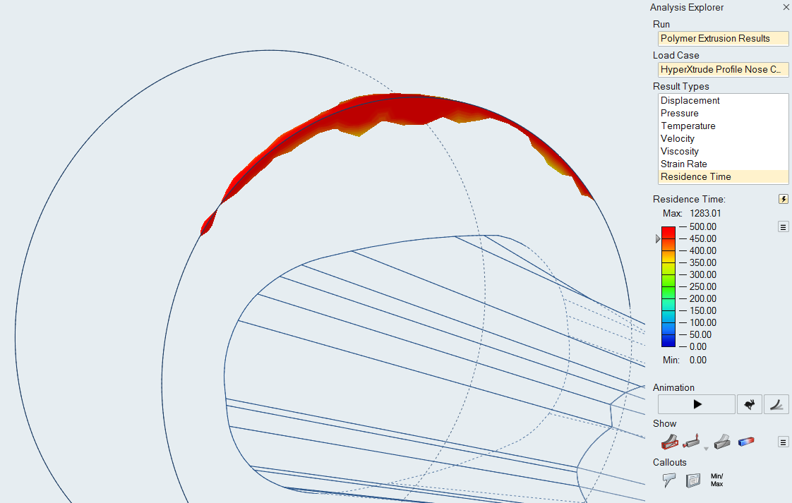

- To locate dead zones in flow domain; you can set max value in legend as 1.5 to 2 times this max residence time (i.e. around 500 for this model).
- Move slide bar to hide value below slider level value. You can see regions
with high residence times only. Regions visible will be possible dead zones
in flow domain of extrusion.
