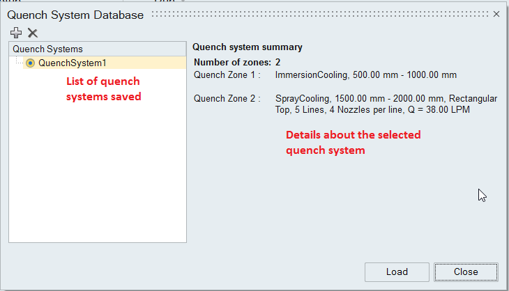

Quench System Database
The quench system database allows you to save created quench systems. You can retrieve the stored quench systems from the database to reuse in future simulations.
Add a Quench System to Database
To add a quench system to database, quench system setup must be completed. You can add only the current quench system created/modified in that session.
Delete a Quench System from Database
- Select the quench system to be deleted from the list.
Click on the
icon to delete
the selected quench system.

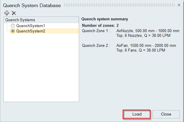

Load a Quench System from Database
