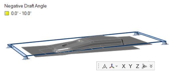

The stamping direction is automatically estimated based on the part's geometry or FE mesh, and the orient plane is displayed.
Orient the stamping direction.

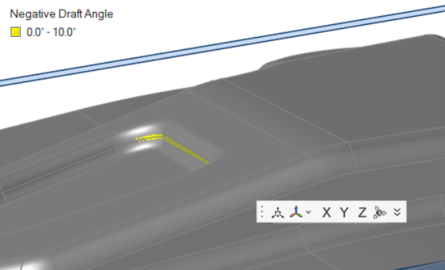

cosines. - Monitor the Negative Draft Angle by using the the legend. Red areas are unfeasible, and yellow areas are passable.
