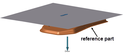

Define Reference Part
Define a reference part in your model for a springback operation.
The reference part helps to locate any defined constraints on the formed part shape. This is helpful when a multi stage forming process is required and the formed part shape before springback is no longer available.

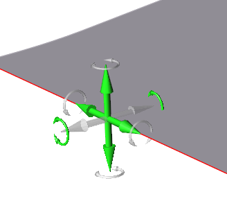

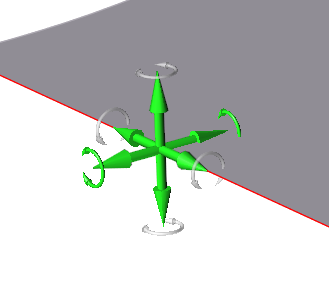

Translate or Rotate Constraints
When you create a support, translation is locked in all directions by default; you can edit individual supports to allow translation in one or more directions.
Supports applied to a point, line, or face can translate in up to three
directions.Apply a Constraint to a Cylindrical Hole
