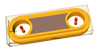

Measure Box
Use the Measure Box tool to measure the dimensions of the bounding box for a selected part or generated shape.

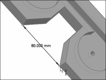

Measure Distance
Use the Measure Distance tool to measure the distance between two points.

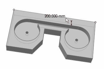

Measure Length
Use the Measure Length tool to measure not only the length of an edge, but also the radius of a circle or an arc, and the diameter or length of a cylinder.

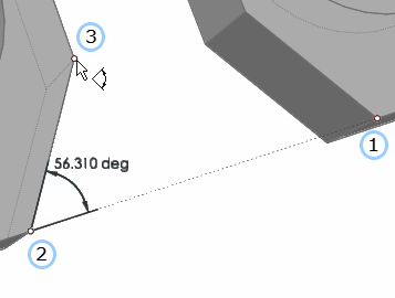

Measure Angle
Use the Measure Angle tool to measure an angle defined by three points.
