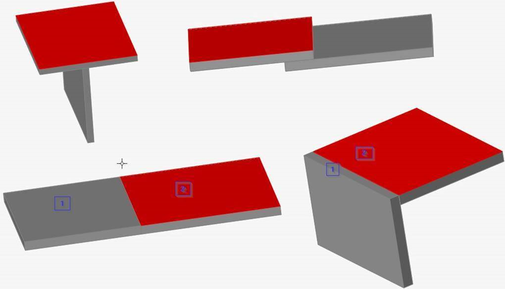

Orienting the Model
Use the Orient tool to align the orientation of the plates.
Inspire Friction Stir Welding follows the convention that the pin moves in the negative Y direction and plates are oriented accordingly. Sometimes the imported CAD model/plates may be oriented in an arbitrary direction. In order to correct this and reorient the model, use the Orient tool.
