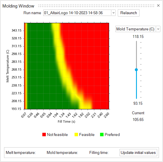

Use the Molding Window to calculate the optimal Mold Temperature, Melt Temperature, and Fill Time for the model.
The Molding Window tool analyzes your model and shows optimal temperatures for the mold and material as well as optimal fill time for the molding process. You can adjust one parameter at a time to see how different settings in that parameter affect the optimal settings for the other parameters.
Optimize Parameters
Use the Molding Window tool to find an optimal combination of mold temperature, melt temperature, and fill time for your model.

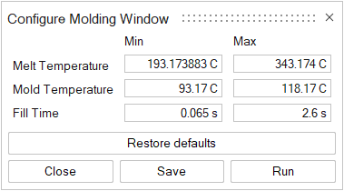

Configure Molding Window
Use the Configure Molding Window tool to customize the minimum and maximum values for mold temperature, melt temperature, and fill time for your model.
