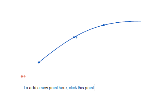

To Do this Reposition a point - Drag the point.
- Click the point. In the microdialog, click the chevron, and then enter the X, Y, and Z coordinates.
Add a point - To extend the blend curve, click the plus sign near
an endpoint.
- To insert a point on the blend curve, click a plus
sign.
