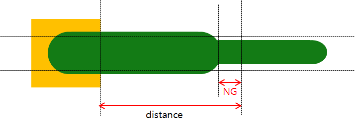

In almost cases, pattern connected to pin should be thicker than a certain width and should keep its thickness within a certain distance.
- Checking
- Item: Specify the item name.
- Component Group: Select target components from the component group list.
- Exclude Component Group: Select void-checking components from target components by selecting component group from the list.
- Criteria: Select criteria to define pass or fail.
- Minimum: If a target component pattern is thinner than the given width, it is fail.
- Maximum: If a target component pattern is thicker than the given width, it is fail.
- Same: If a target component pattern has the same width as the given width, it is fail.
- Pattern Width: Specify the target pattern width for checking.
- Distance: Define the pattern width keeping distance from the pad
edge. If the pattern doesn’t keep certain width within the given
distance, it is fail.
Figure 1. - Pass/Fail Option: If multiple patterns are connected to one pin and
even if a pattern satisfies the given condition, all connected
patterns are passed.
