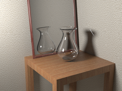

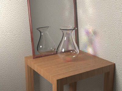

The object does not scatter light. That is, rays of light do not get deflected in different directions. Do not receive caustics
The object does not receive caustics. Caustics are complex refractions caused when light passes through transparent objects.
Figure 1. Do not receive caustics
Figure 2. Receive causticsHide back faces
