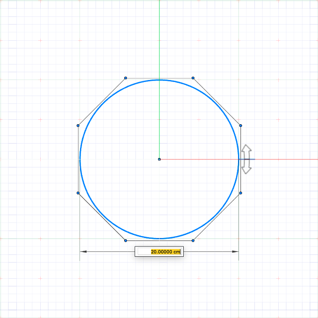

Select a degree option and then reposition or change the number of the control points in order to manipulate the shape of a freeform circle/arc.

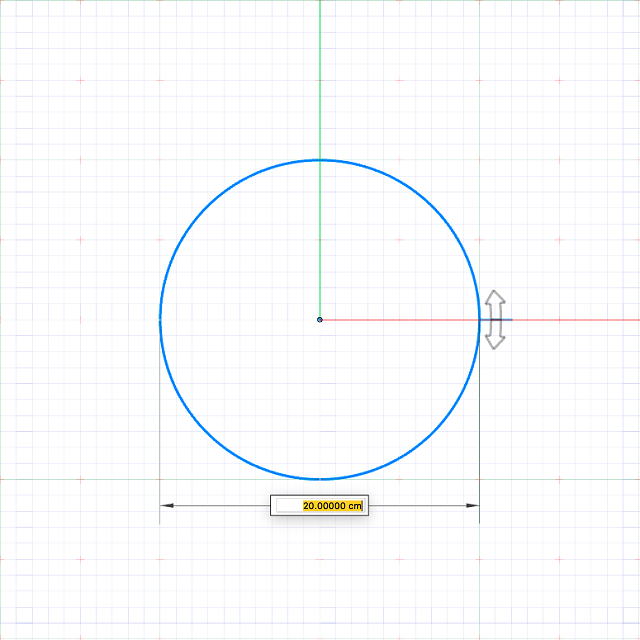

If you want to manipulate the shape, select one of the degree options.
Figure 1. Exact
Figure 2. Degree 3
