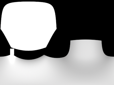

Examples of HDRIs
Figure 1. Example 1: HDRI created in Inspire Studio |

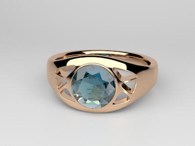

Figure 2. Example 1: Final Rendering Using the HDRI created in
Inspire Studio |

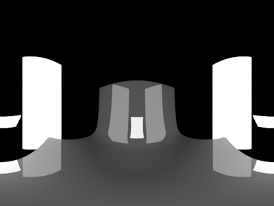

Figure 3. Example 2: HDRI created in Inspire Studio |

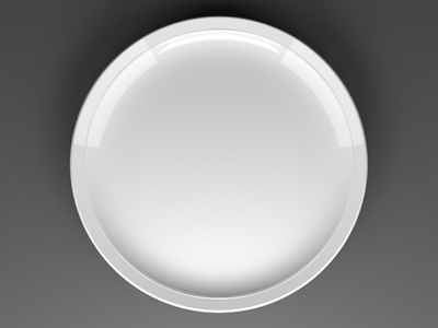

Figure 4. Example 2: Final Rendering Using the HDRI created in
Inspire Studio |
