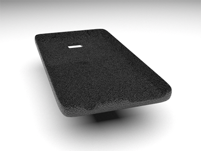

Figure 1. Satin Black Plastic from the Material Library - Presets

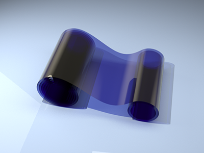

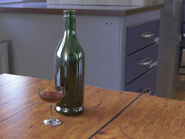

- Thin Film: Create a hollow object with an extremely thin, transparent surface like a thin glass or a soap bubble. Thin film allows light to pass through without bending or scattering, so you can achieve perfect reflection and transparency. You can also produce an iridescent effect.
- Glass
- Plastic
- Polycarbonate
- Water
- Various minerals including precious and semi-precious gems.

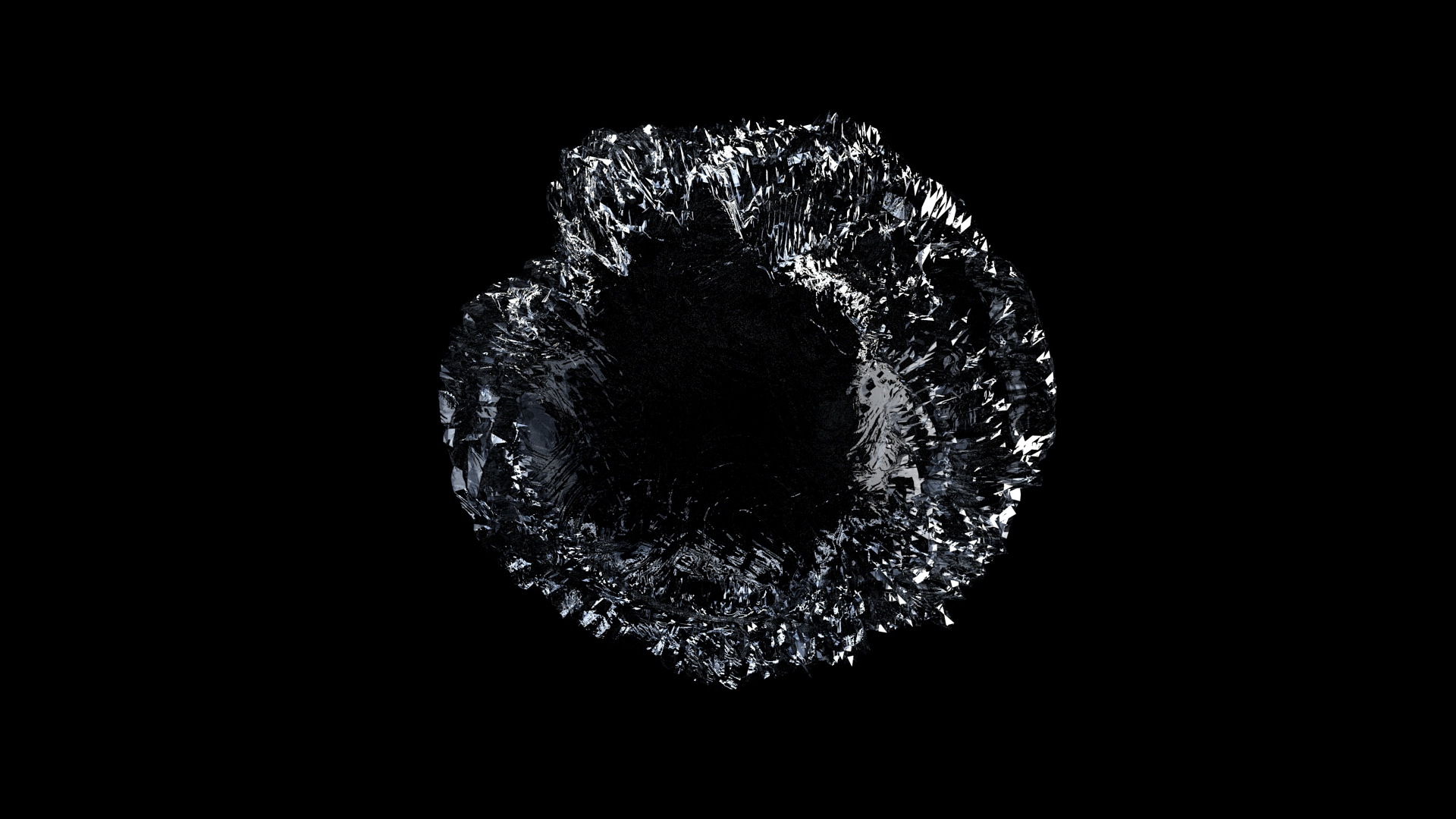

Figure 2. Example of Thin Film

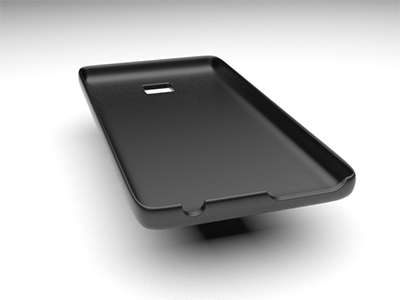

Figure 3. Example of Glass - Reflectivity

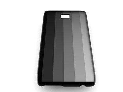

Figure 4. Satin Black Plastic with the Image Gray_Scale.jpg (Contrast 50), White (Default Color), and Reflectance 50%

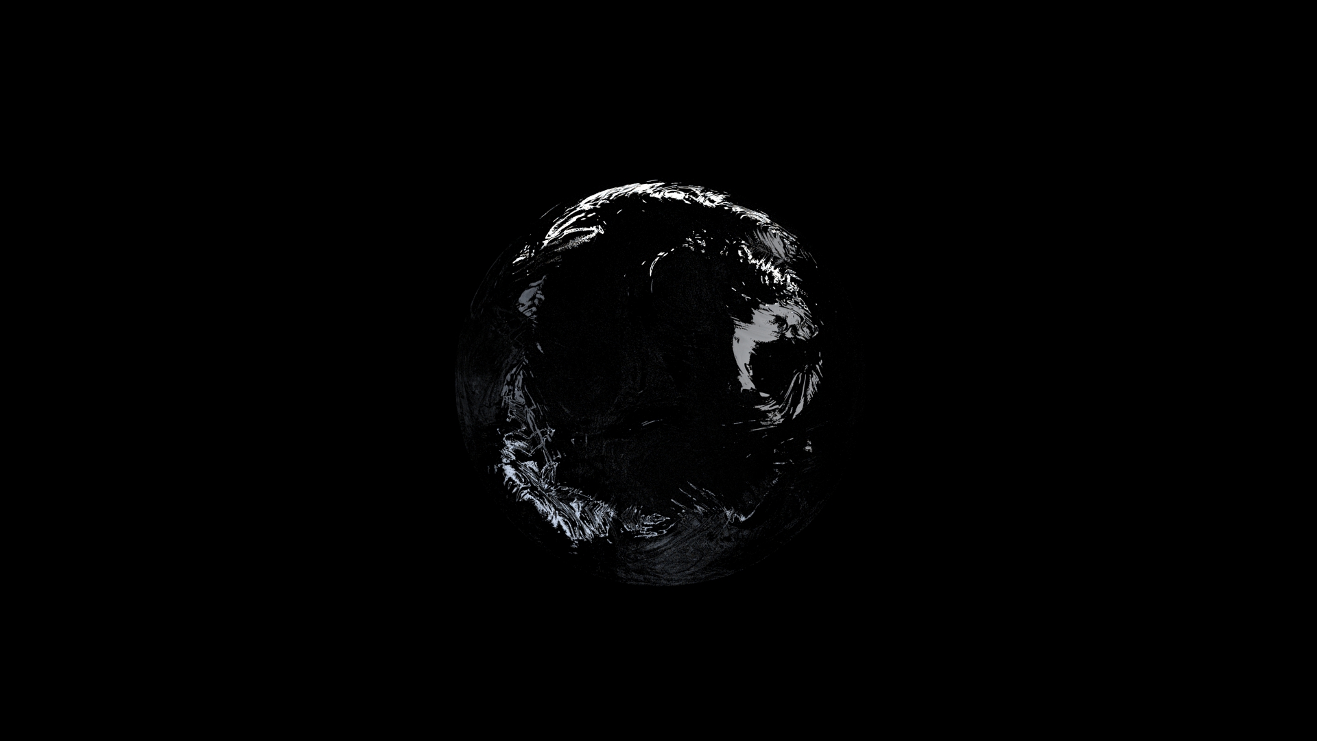

Figure 5. Satin Black Plastic Blended with the Image Noise09.jpg (Molds Folder) - Reflectivity Boost

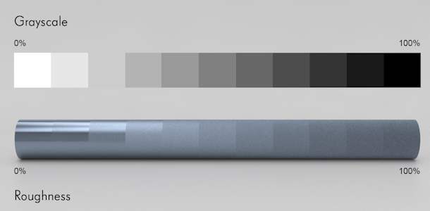

- Roughness
- Roughness adds texture to the material at a microscopic level. When you
modify the roughness, the surface texture still looks the same; however,
tiny changes invisible to the naked eye have occurred, affecting
reflectivity.
To add a roughness map, upload an image.
0 can produce a perfect mirror reflection.
Lower values produce crisper and brighter reflections.
Higher values produce blurrier, dimmer reflections. Increasing the roughness spreads and distributes reflections over the surface and creates a more matte surface.
At values approaching 100, light becomes so scattered that reflections are barely visible, if at all.

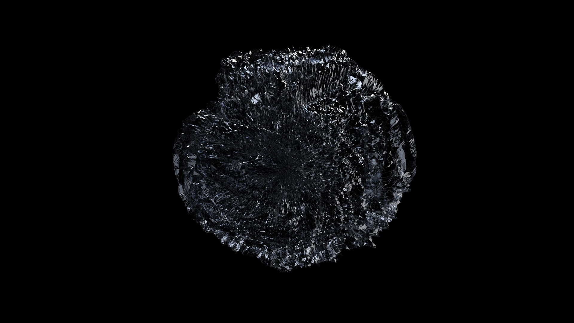

Figure 7. Subdivision: 2
Figure 8. Subdivisions: 6Texture: Upload a texture map. Colored images will be mapped as grayscale.

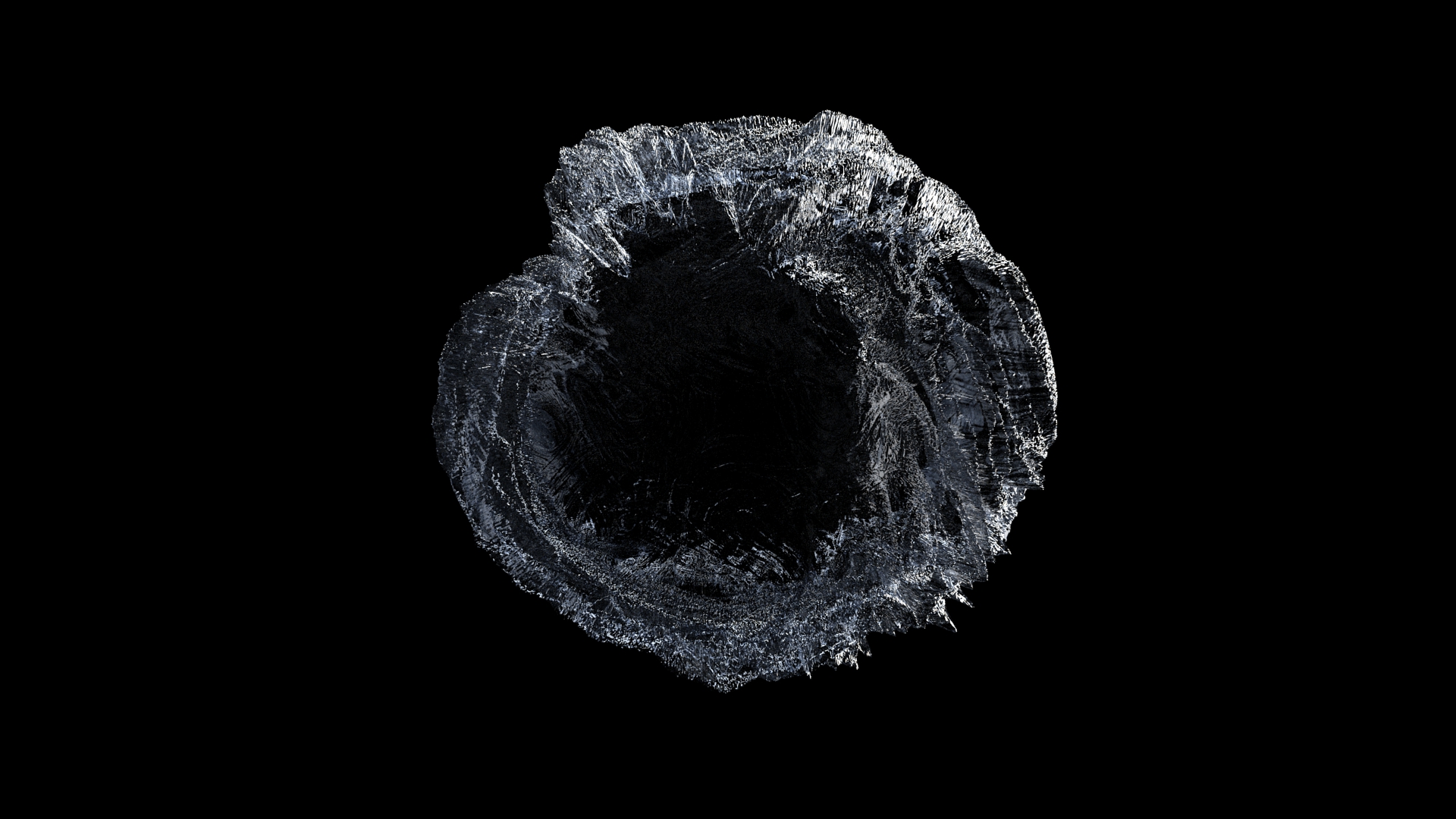

Height: Set the maximum distance displaced. For displacement to appear, values must be greater than zero; the default is 2 cm.
Figure 9. Height: 0.5cm

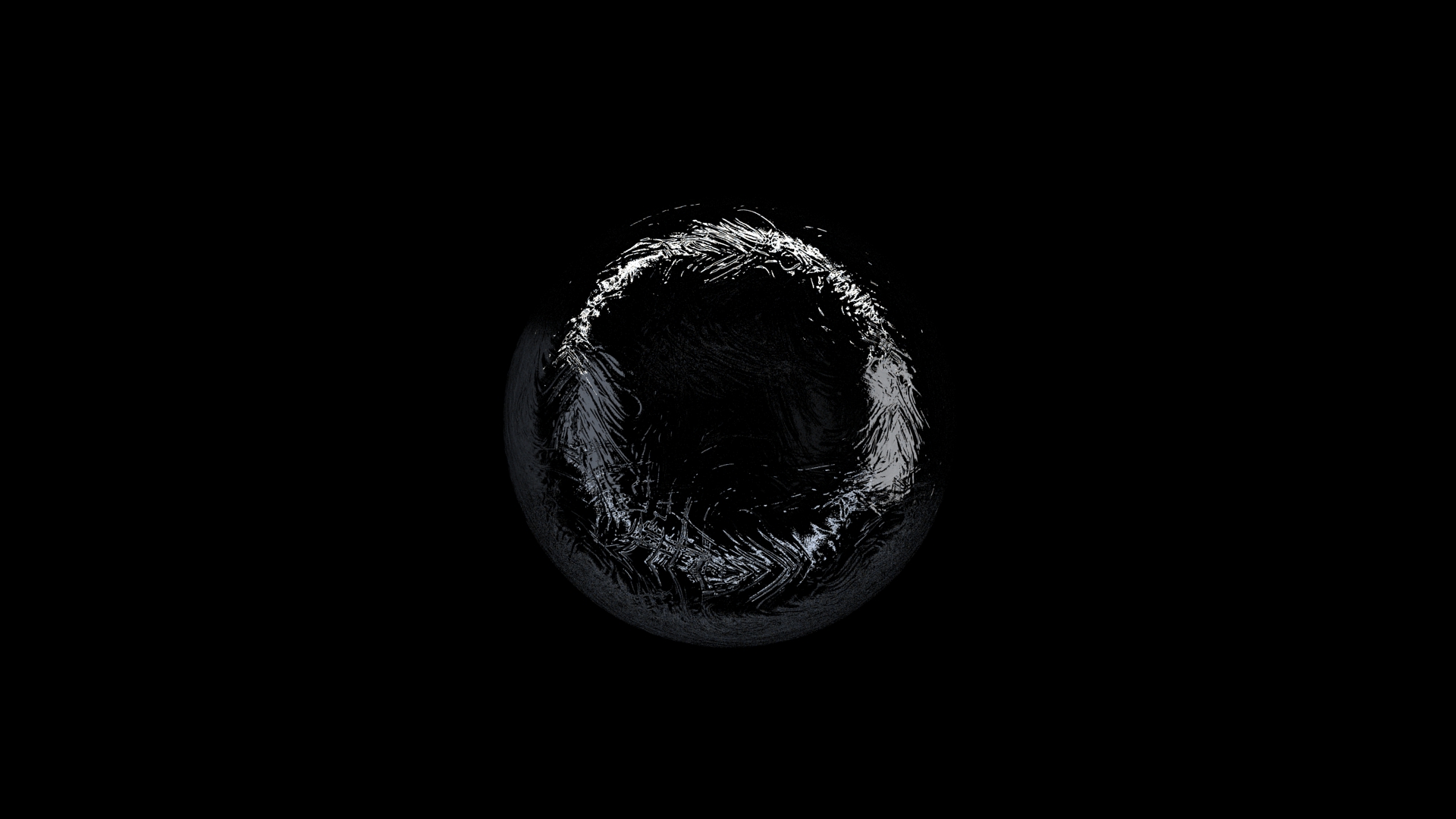

Figure 10. Height: 25cmCenter: Invert displacement. This feature is useful for positioning objects along a ground plane. For example, adding a displacement map to a carpet may make it look like it's floating. Reducing your center will bring it back down to the floor. Adding a displacement map to a floor may result in objects intersecting with the floor. In this case, you could increase the center to avoid intersection.
Figure 11. Center: 1cm

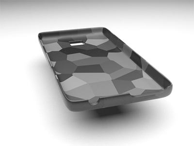

Figure 12. Center: 0.1cmNormal Smoothing: Enabled by default, to render smoothly (continuous shading). Disable to render in a faceted way, which is useful for rendering very sharp, detailed displacements such as sharp corners.
Figure 13. Normal Smoothing Disabled

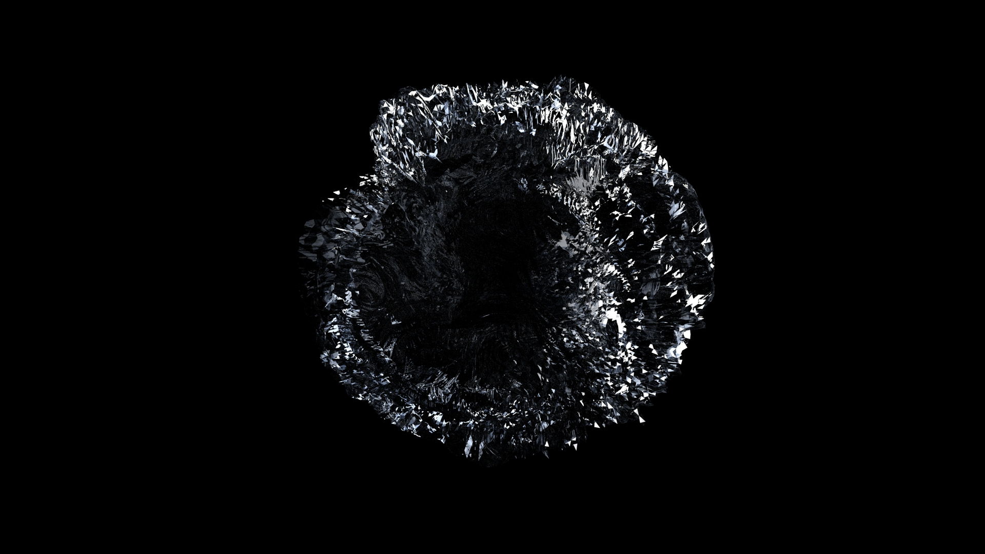

Figure 14. Normal Smoothing OnTight Bounds: Enabled by default. This feature lets Inspire Studio compute more precise bounding volumes for the displaced surface, leading to slightly better rendering times. Since this feature is performance-based, check your engine settings to enable your fastest processors.
Figure 15. Tight Bounds Disabled
